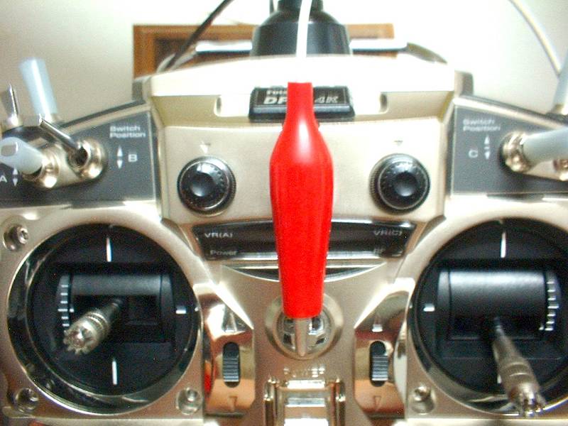

rcgood, some Tx/PC combinations seem to show more grounding problems. What I can suggest to you is to prepare a simple cable of suitable length with a crocodile clip on each end. Clip one end to the strap hook of the Tx, and clip the other end to the metal casing of the PC. This should resolve your issue.
