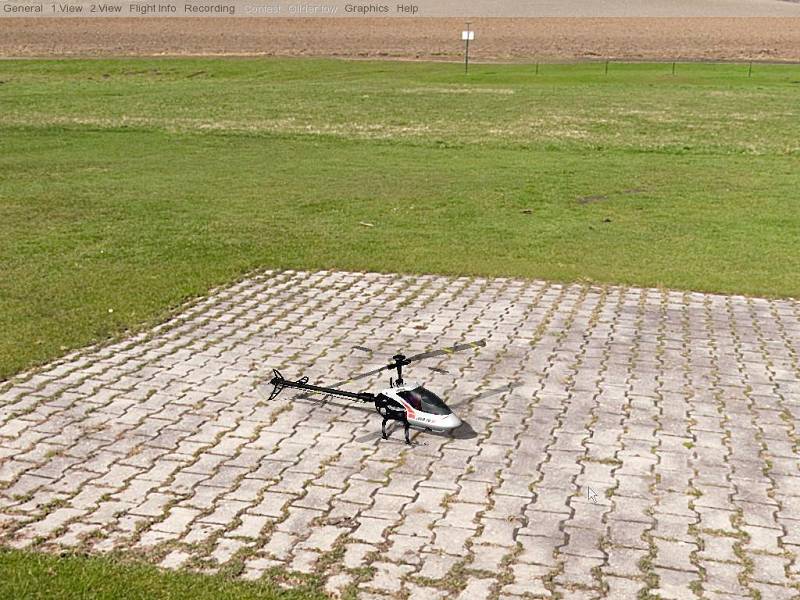

I was hoping someone can help me out. I have been trying to install the Logo 10 helicopter model from the www.rc-sim.de website. I haven't had any luck at all. I tried using the procedures on this forum but still can't get the model to show up.
Please help!
Thanks in advance

Hi Bullseye, I just tested the download and it works fine. In your download, you'll find the "aircraft" and "sound" folders. Open the "aircraft" folder and you'll see the "logo10" folder. Just drag and drop the "logo10" (not the "aircraft" folder!) into your AFPD "aircraft" folder. Then open the "sound" folder and you'll find the "eheli2.wav" file. Just drag and drop this file into the AFPD "sound" folder.

I tried that procedure but unfortunately it didn't work. I went ahead and looked at another post that you had about changing the TMD file to read version: 1.8.0. That did the trick. The model works perfectly!!
Thank you so much!!

Bullseye, well done! Yes, if you don't have any addons, then you're on version 1.8.0.x and what you did was correct.
