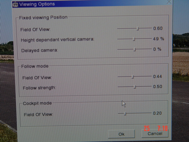

I got the same problem with mr:Pat,The camera fail to follow the airplane and normally cut of at the top of the screen.( If the airplane fly just a little bit high and then I won't able to see it any more) I do have 04 add on disks installed to my pc.again here is the pc spec:
-Hp Media center m7287c
CPU 3mhz.
Graphic card:FORSA Geforce 7900 GTX.
500 plus DRAM.
Controller is Spextrum DX7 .
Up date with new current patch:1.11.07.09
Any Idea? Thanks!

Hi hvta, in the flying menu, under view1->viewing options what is your setting for the height dependant vertical camera?

Under Fixed viewing position window I have:
-Height dependent vertical camera:100%
-Delay camera: 0%
hvta

hvta, reduce your "height dependant vertical camera" and you should solve your problem. You could try a % between 50 and 100

Yes! When I reduced the height Dependant vertical camera to 50% It's work great".You 're the man".Thanks!

Hi hvta, great! I actually use 100% for the vertical camera delay as I like to do spins (upright, inverted, and KE) from a higher attitude. You'll find that with a lower setting, your flying attitude is limited. It's a matter of personal preference.
