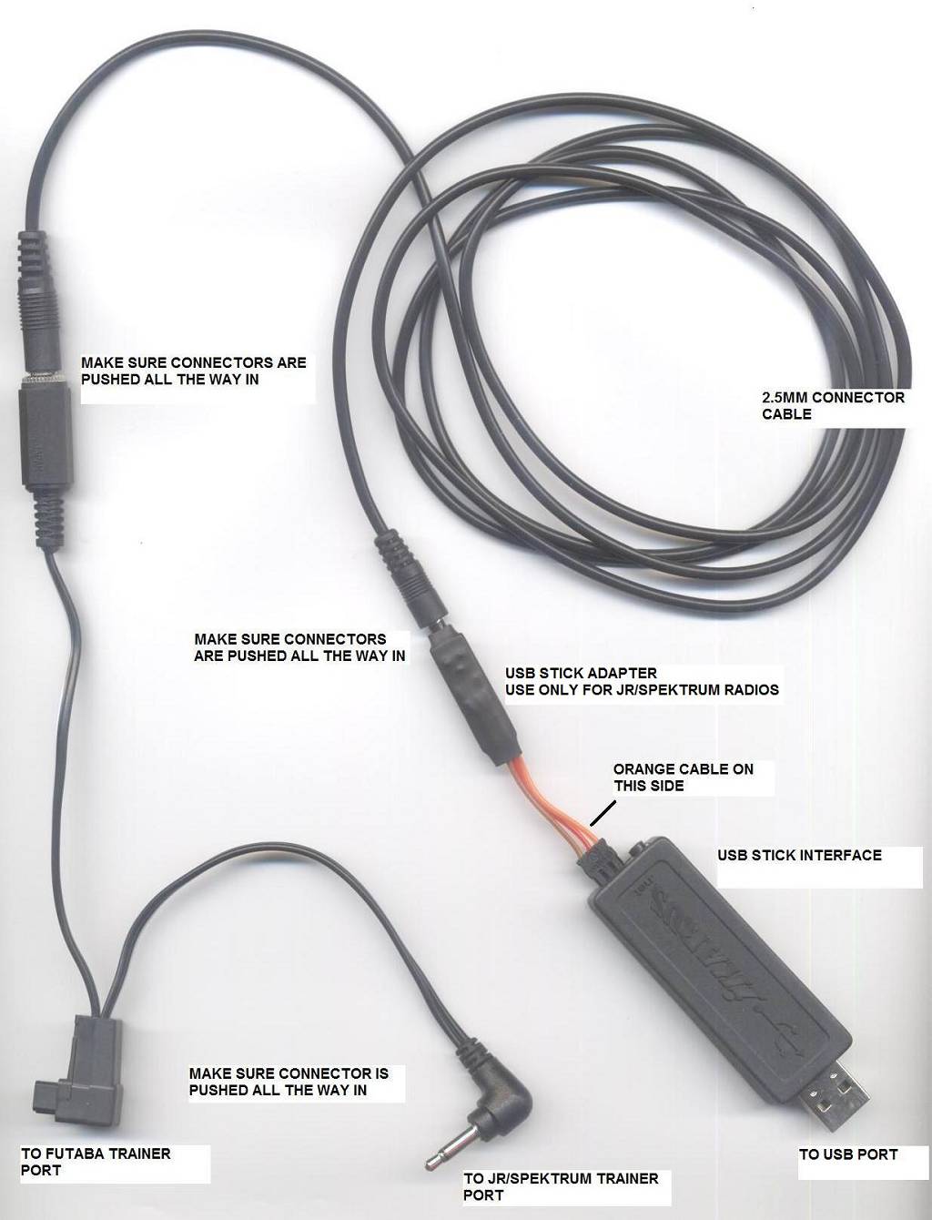

Hi,
I have justed purchased the AeroFly Pro Deluxe from Tower and have the JR adapter as well. I am having issues with AeroFly not seeing my radio on the Mac version. I have updated to the latest patch with no resolve.

Please post a photo of your cable connection between the DX6 and your usb port

Sorry to steal your photo from another post, but this is the setup I am using. I have been looking at the posts to try to help myself before asking you a question.

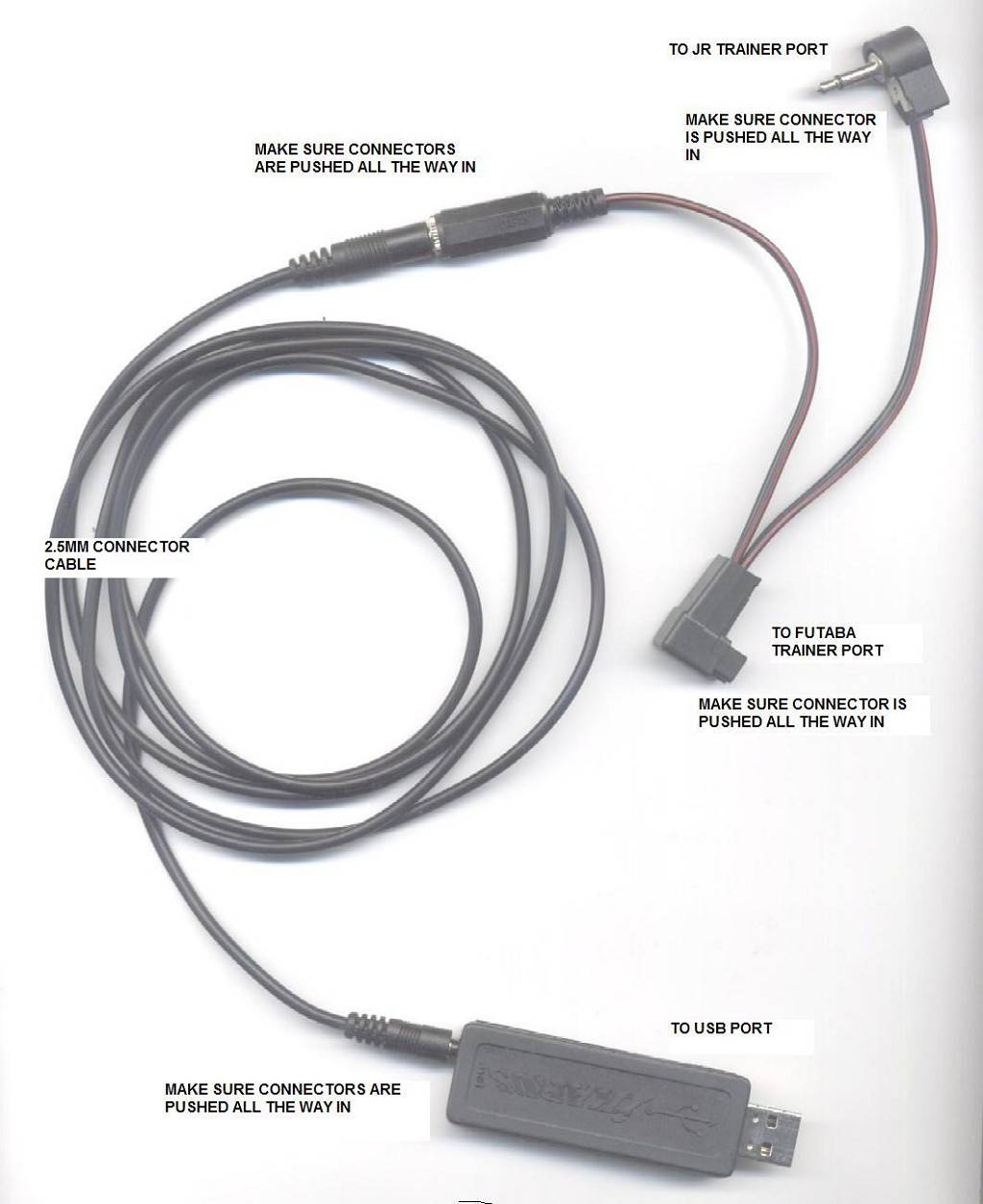

For JR and Spektrum radios, the connection should be as the attached diagram. Keep your DX6 main switch off. When you plug in the adapter cable, the radio should turn on automatically.

I plug in the adapter and I let it turn on my radio, but it still will not show up that the radio is connected.

Did you connect the usb stick adapter between the usb stick and the 2.5mm connector cable? The orange wire must be facing the correct way as per the diagram.
Make sure that all connectors are pushed in completely. Disable the trainer mode in the DX6

I contacted Great Planes for a replacement cable which fixed the issue for me. Thank you for your help.
