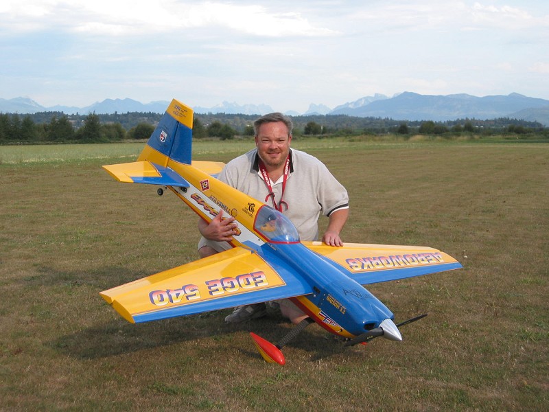

Here is my new IMAC plane... Guess I'd better get busy practicing that sequence...
