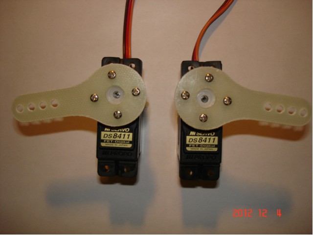

I guess you IMAC guys should know. I am equipping Pilot two 26% Yaks, 30cc. I have used metal servo arms on 115 powered pattern planes, gas is new for me, and have never used these phonelic type. I do not do any 3D flying, just sport, regular stuff. Any reason not to use these ? Appreciate any comments.

You are fine with those arms. Being new to gas, a few things to keep in mind. The biggest is vibration. I highly recommend that you balance the prop. Keep and eye on those arms, the vibration can put a lot of wear and tear on them depending on what links you re using. If you re using ball links then it will not be bad at all, if you are using a pin type link then the wear can get ugly pretty quick.
Also, it is doubly important that you use locktite on anything that is metal to metal, I would highly suggest metal geared servos so the screw that you re going to use for the arm to servo connection will need some blue locktite. DO NOT USE the red locktite and use only one very small drop of the blue. I would also suggest replacing the standard phillips type of screw head with a allen wrench version. Most hardware stores sell these for a few cents each and it is well worth the change over, especially is you use a bit too much locktite and need to remove the servo arm. Even too much blue locktite can cause you to strip the standard phillips head.
Just remember one thing, think vibration and what would happen if something comes loose because of vibration.

To answer your other question, the only place we have had a problem with the phenolic servo arms is on the rudder but since you wont be bouncing the rudder off the grass or dunking it in a kiddie pool you should be fine with them.
Tony produces very high quality kits, he wouldn't supply them if they didnt work.

For what it is worth I personally would never use a ball link on a single phenolic arm. A ball link is offset from the arm and so it introduces a twisting effect to the arm that eventually can cause failure under load. The double phenolic arms found on some models are great in that you can place the ball link between them keeping the load inline. I agree that the pin type can wear but as long as you check them for play once in a while a good quality clevis with a fairly large size pin should last for quite a while and I would much rather deal with a little wear than a broken arm in flight. JMHO

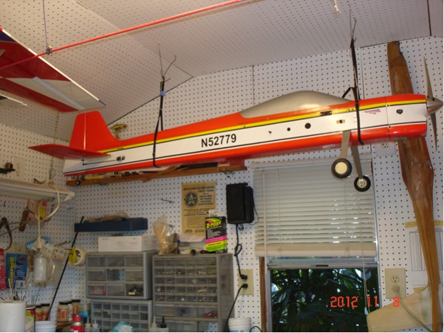

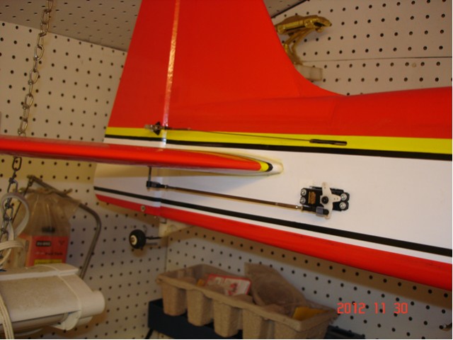

My Feedback: (15)
Posts: 2,808
From: Lake Placid,FL
Default RE: Seervo Arm Advice
I am using the stock arms on another plane, 115 powered, works fine. Being new to gas and more vibration, I will go slow.
Thanks for all info.
Crank

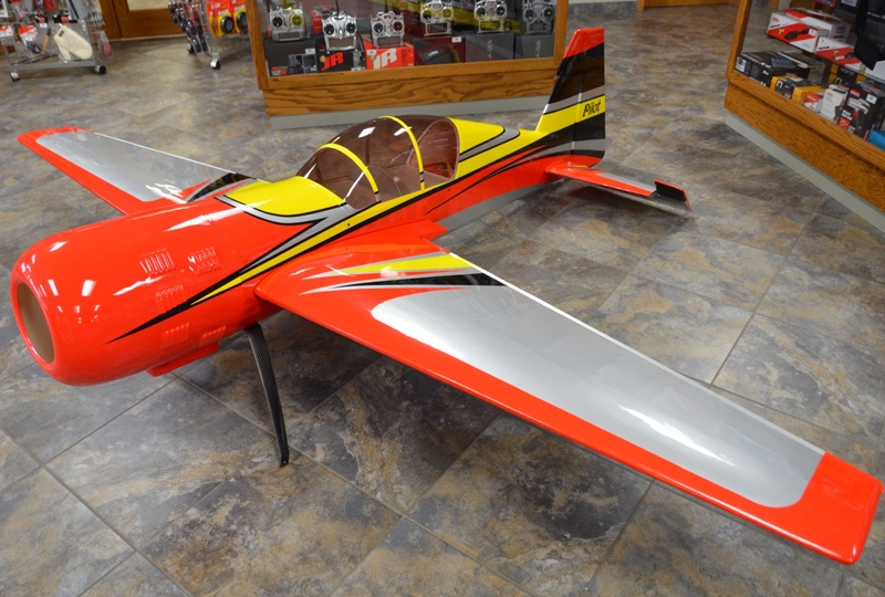

Hey Andy - Get this one in the air, do the other one, thinking of different power, I think Mintor. I had to flip to see which one to put together first. I beleve this is their 30%, same color scheme as the 26, looks good out of the box.
Crank

The Fiberglass arm is not the problem, it's bolting it up to a plastic servo wheel. Use a metal wheel....the splines in the plastic will likely strip at some point (when you don't want it to)
I just use a metal arm instead.

I owned and nearly wore out 3 Comp Arf 3.3 Yaks, the servo installation instructions had you install phenolic arms on the stock plastic servo wheels and on all 14 servos. In 5 years of hammering these airplanes not even one stripped out; now they were ganged together mind you, 3 on each aileron, 2 on each elevator and 4 on the rudder. Just saying.
