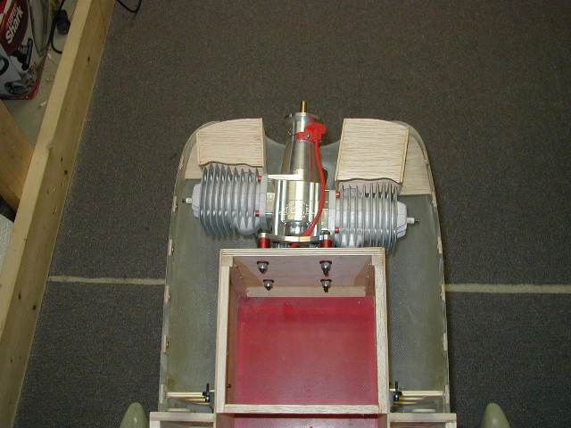

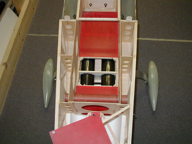

I finally got some pics. I made the mounting plate from light 1/4" ply. Drilled two 3" Holes for the cans and then drilled a bunch of 3/16" holes around the perimeter of the 3" hole. I then took fuel tubing and laced it through the holes. Dalton aviation makes a fiberglass plate to go over the pipes and they can make it any color you'd like the best part is that it is only two oz.

Hi, Rob. Here's some pictures of the baffles and sub floor for the cans. I made a different former for the cowl's bottom half as you can see in the pics. I have two bolts per side. This makes the bottom half nice and solid when you remove the top. Also I cut slots on the bottom of the fuse for the hot air to come out. I don't like the looks of a single big hole on the bottom, so I made four 1/2" x 6" slots instead.
