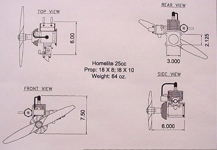

well the homelite rtf is about 7 1/2 inches tall, 6" wide... too big I guess...? Unless I let it stick out the bottom and made some kind of miracle custom exhaust...

I noticed a price you found for the 25cc in a previous post (near the top of this thread). I got my first one from www.gcbmrc.com for $210.
Of particular note:I think Bill Carpenter at C&H ignition mentioned he has a bunch of craft with this engine installed. Contact him at www.ch-ignitions.com or 307-857-6897. In that he supplies most of the gas engine manufacturers with ignition gear I would think he would be an excellent source of info for you.
Doug

If that 25cc Homelite conversion weighs 64oz. you don't want to put it in a 72" Extra. It's way too heavy. You need to stick with glow or buy one of the lighter (read more expensive[]) gas engines. The Brison 2.4 may be your best choice: low weight, good power, great running, and a reasonable price. Good luck!
p.s. Just for comparison, my Brison 3.2 with pitts muffler, ignition, and battery weigh just a few ounces more than that bare Homelite conversion...food for thought.

Thanx... I'm starting to think I'm just going to go glow like a ST 2300 or similar... The ST is 38 oz... about 2 pounds lighter i guess... I just hate glow fuel costs... Homelite is so easy for me to do cause the base has a full machine shop with welding capabilities that i can use... Oh well
