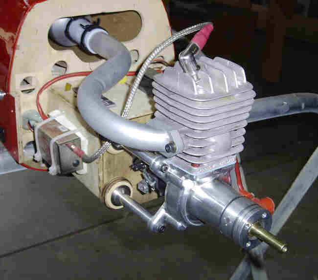

ORIGINAL: ilrcflyboy
The Aeroworks 29% Katana is designed for a canister on the DA 50. I've surpassed 85 flights on mine and love it. Check the giant scale forum for more info on it.
They have a good price on them right now as well (A LOT less than what I paid!!).
ilrcflyboy do you have the cannester on yours? I'm in the process of assembly on mine & would like to do the cannester as well. Did you use the KS from DA & if so what header or combo of plumbing to get the exhaust to the can.
Steve

Yes they have a header but it will take a Swan neck type of pipe to get from the side of the jug on the engine to the center of the fuse. They sell a short "manifold" and all kinds of "plumbing" pieces to get what you need but without knowing just what to use I guess I'll have to buy a bunch of different pieces to get the shape I need & then someone to weld it all up. Better yet do a little measuring & get some one to make me a pipe with the demensions I need. I think Paul at Just Engines is pretty efficent at doing this!
Here is a pic of what I'm talking about

It's not quite that complicated. I sent DA a message asking if they had a header to work with the DA50 and the pipe on a Katana. This header is sometime referred to as a question mark header. This is the response I got from DA: "We do sell the header that Aeroworks used in the 29% Katana. The header is a mtw double bend 50mm drop header and costs $36.00 plus shipping."
Just contact DA and they will help you.
