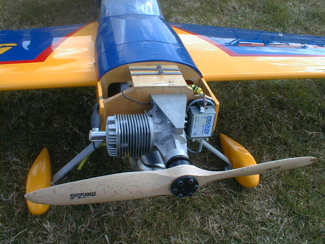

see attached pic of Dave Ashcroft's Edge with Mackay 30 HDS and KS 76 muffler. Menz prop 20/8 for running in, now flying on a 20/12 Engel Carbon.

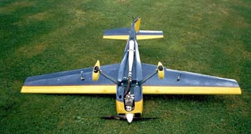

John has fitted the pipe into a 300 mm deep balsa tunnel

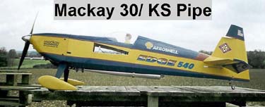

side view of John's aircraft
