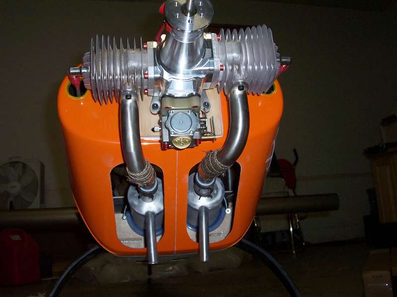

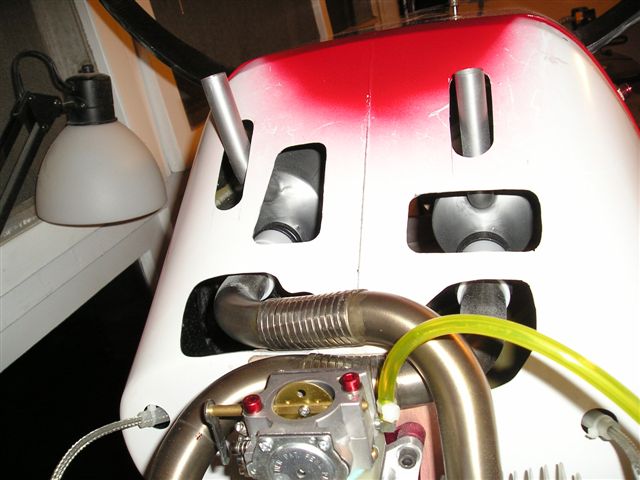

Here are some, MTW crossover headers and KS cans. Works great. Going to check out the full length pipes though, that sounds cool LOL.
RickP

ORIGINAL: RickP
RickP
RickP: Have you ever had the KS system in a plane with out the cross over headers? Can you tell me if the cross over has a noticable improvement in the 1/4 throttle range? I'm currently running straight heades to KS Cans. Headers are 12.25 in. long. How long are those? Thanks,

Don,
I don't believe that the cross over headers are good for any power increase. The only benifit is that you can get larger cans in a Comp ARF 3.0 then you could normally. And the larger cans should be good for more power HTH.
RickP

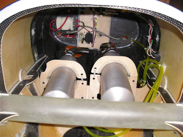

Hi there I just seen this thread,
here is a simple method of installing cans in a 3 meter or super-xtra
