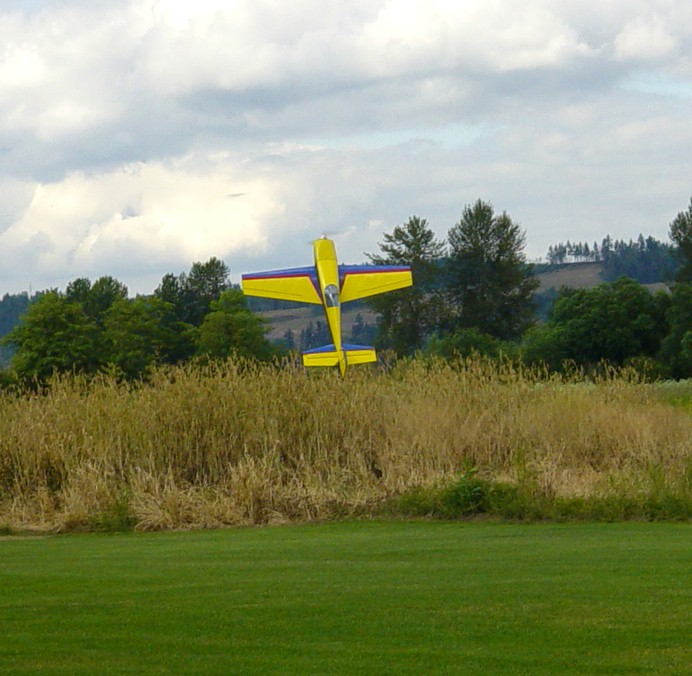

Even at 2500' a 50cc engine should give you unlimited performance. Mine was built stock and has great performance with a Brison 3.2.
