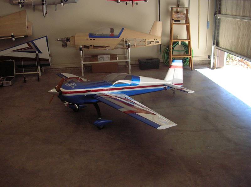

I have about 30 flights on a 27% Planes Plus Extra with a DA50. I have experienced several issues and I would like to know if anyone else has had this same issues. I have had glue joints come loose on the hatch hold downs, as well as the formers in fuse and servo trays in the wings. Recently at the practice field, the rudder hinges snapped into while flying the sportsman pattern. I was able to land with the rudder held on by the pull pull cables. Any advice?

I have had many of the same issues you have had. I completely recovered mine. The Chinakote had to go. During the recovering process, I found that none of the fuse stringers were glued to any of the formers aft of the gear block, you might check yours. I also found that many of the rib cap strips were not glued either. I replaced all my hinges with Robarts.

It's fitted with a Graphite landing gear for the Colombo Anderson. It fits great.
