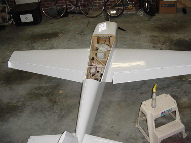

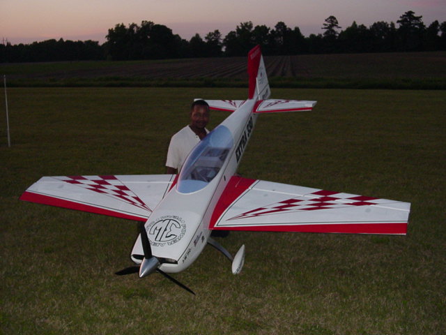

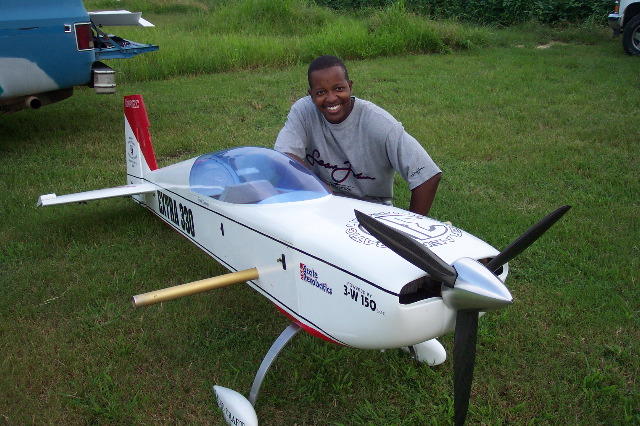

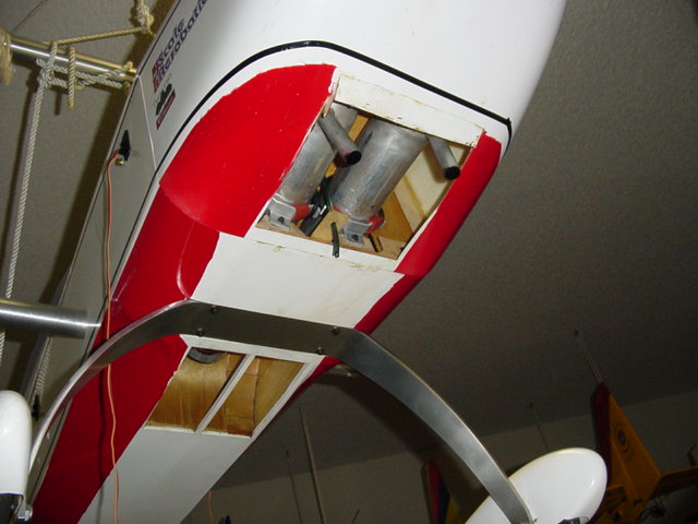

i run a 29 x 12 x 3 fuchs on my 3W
ID:	432267   Click image for larger version
ID:	432268   Click image for larger version
ID:	432269   Click image for larger version
