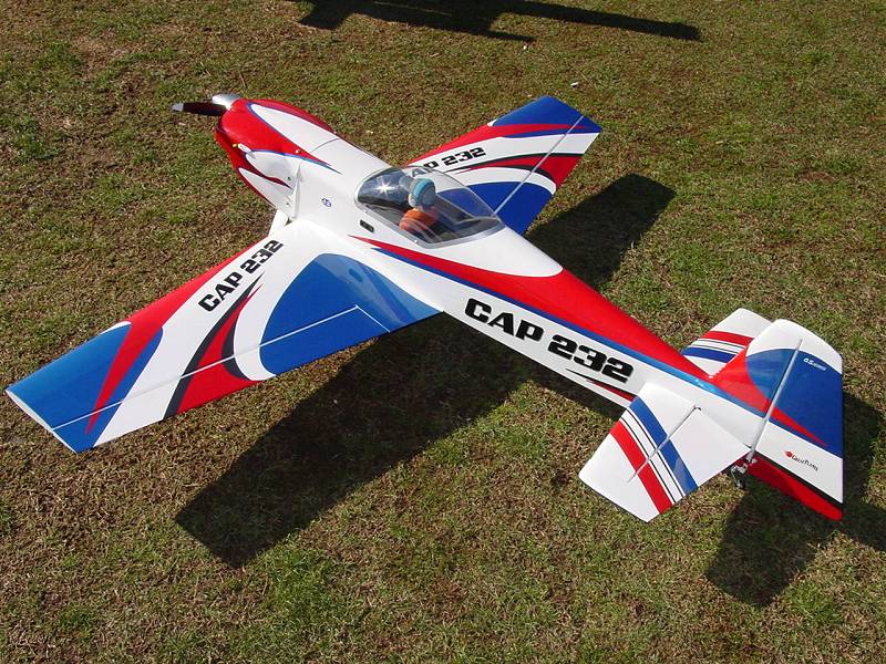

Here are some pictures of the Great Planes 79" CAP 232 that illustrates the much lowered position of their stab.
I don't want to get into a brawl with Dick Hanson over this stuff. Dick is a well known designer and builder. Please take my information more as a data report for you to do with as you see fit.
Regards,

Thanks for the pics, Eric. I had a look through their site as well and it is apparent that the stab is much lower than any other 232 I have seen.
I don't want a brawl, either. I'm just trying to get the best flying Cap 232 I can. I respect Dick's resume and advice and yours as well. What I do with it is up to me. As mentioned, CofG and many other set up items can influence this, even a particular flyer's choices and preferences for control throws and style of flying. There is no magic bullet for this stuff and it takes trial and error and some compromise in the end. From this discussion and other reports and comments I have seen, I will be lowering the stab some, for an easier/better structural arrangement and to reduce coupling. If it goes wrong, I will have no one to blame but myself...

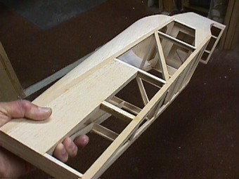

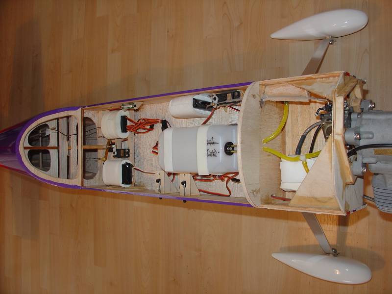

I have done this exact same size --both ways and the tube joined wing model was lightest - however that is because the entire model was -piece by piece -lighter -lighter cowl and canopy also
typically the CAPS I did this size are 10lobs with a YS140 and 13 with a ZDZ40 and can
I also flew the H9 80 " setup with a ZDZ50 and a in cowl setup I designed - very good flyer but almost 3 lbs heavier
The dihedral was close enough with the 10% tip and 12% root - and flat along top high point
Note in the interior shot --the forward fuselage ass'yis an I beam --on it's side - this is incredibly stiff and light made from laminated balsa and spruce longerons .
I'm not sure I have this right. Are you referring to what looks like the fuse floor? It appears to be spruce longerons on each side with an end grain shear web in between, is that correct? Then you simply have a framework to support the covering and form the exterior bottom of the fuse? At least that is the way it looks in the fuse shot from the tail forward.

I showed the fuselage on it's side - - --Imagine an I beam-the sides are top and bottom -the floor in centre is the upright
Each side is laminated balsa -light stock - bonded at 90 degrees .
the bulkhead is als laminated
The spruce carries the load fore/aft - the floor does two things: It makes the fuselage absolutely rigid against any "racking"
secondly the exhaust system is below - isolated from anything else.
Got it. I understand the I-beam concept, was just trying to understand which piece was doing what in your pic.
