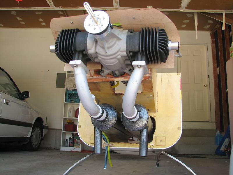

My own fix is easier - I run two large, open, non tuned cans on my 42% Radiocraft
The engine/ can/ prop combo ZDZ160J/JMB cans/14x30 ZM prop, is extremely quiet and having given the model to other fliers to try, all agree this setup is absolutely seamless in throttle response.-
The big difference in my setup and your in cowl muffler setup -is noise reduction. (mufflers and higher pitched two blades)
If you decide to try in fuselage cans --avoid any which require specific header lengths - these also tend to have a step in them if the prop load is not matched .

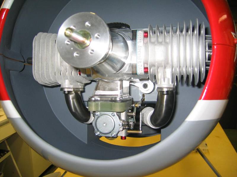

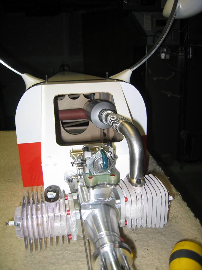

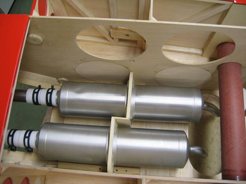

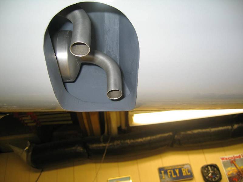

Dick, Again, thanks for the advice. Attached are pics of what my setup was that is givig me problems, I have in the mean time put the stock mufflers back in the plane to try to get some flights on the plane. Other then mine being rear exhaust, it looks like I am using a simialr can mufflers that you are.

I have the current Super 160 (like Dick shows in the picture) with the exact same headers and JMB mufflers in a 40% scratch built 260 and find that the power is way more than adequate, the setup was easy to do and the throttle response is great. For me, if power is already in abundance then this is the way to go. If you need more power, I can certainly understand why the tuned pipes would be a consideration. I see guys putting 150/160 class engines in these big planes (like the CA 3.3 Yaks) and going to the tuned pipes- they seem to be happy with them but, if I were to do one, I would just go to a bigger engine and try to forgo the pipes.

Dave, You may have misunderstood something. I am using the can muffles from KS, not the tuned mufflers that look like softball bats, as I call them. Mine are short and fat with a rear exhaust. If I came across as them being a tuned muffler, I may be at fault in my description. That is why I attached some pics.

not all cans are the same internally -far from it
basically a short head pipe then a large interval from end of pipe to baffle (say 4-6") will give best NON tuned performance - the larger diameter (higher volume expansion room) is also a big help.
the "tuned cans" are trickier to get right --than proper tuned pipes .
getting more power is easy --getting good even throttle response - not as easy . For my money the big JMB beat any of the cans on the market - they are NON tuned . just make shortest possible header and go fly
