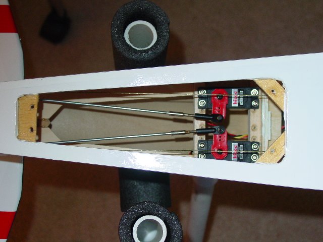

I am in the process of rebuilding my Ultimate after a crash, and I want to put the elevator servos in the tail. I have a Saito 120 on the front and before I crashed it, I had some lead in the tail, so I want to eliminate the lead and put servos back there. Are two JR 537s to heavy, or do I need to use something less? Also, does anyone have any pics of the elevator servo install?

The 2 537 servo will work and you might get lucky and come out just right. Are you going to mix the servos through the Tx??

I'm not sure about the mixing, I have a JR 662 radio, can I run a -harness to the servos, or is there a better way of doing it?

I'm also rebuilding an Ultimate from a crash (happened almost 10 years ago) and have moved the elevator servos to the tail. I have a YS120SF on it now but haven't balanced it yet. I put the servos (Hitec 525's) inside the rear of the fuselage with pushrods coming out the existing slots. Hope to fly it this weekend. Just have to finish the cowl. Here's a picture of the servos. I left the rudder servo in its stock location (Hitec 605)
Chris

Seth, I'm not familiar with JR radios, but if you are going to run two elevator servos you need a computer radio to properly mix and balance throws and trim.

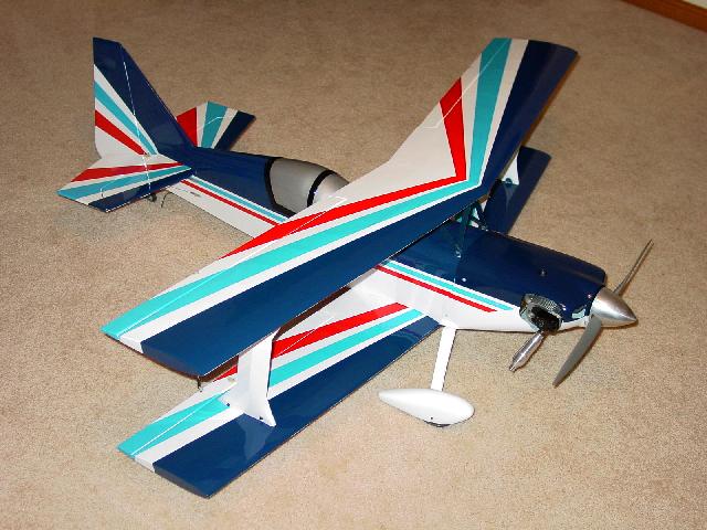

I've now put it together and checked the CG. With the servos in the tail and the YS120 on the front, the CG is in the middle of the range. The battery is near the CG. No added weight. The plane comes in around 9 lbs.

Ha Chris...that bipe looks good and should be really nice at 9 lbs. and the 1.20.
