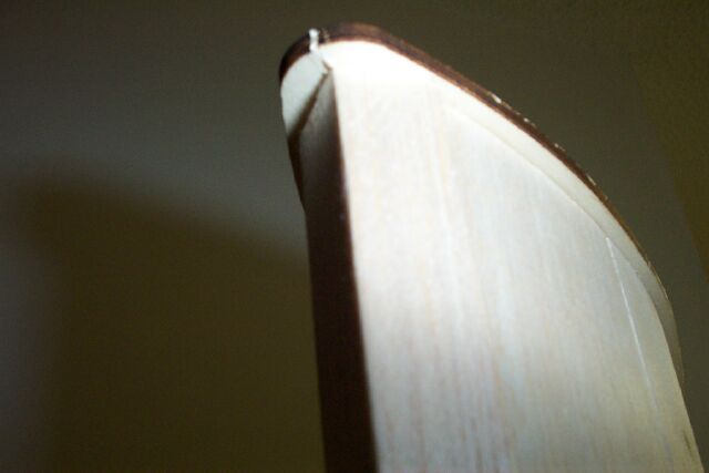

I'm working on the wings and I found that the plywood ribs are almost 1/4 " bigger ( all around ) than the wing, I e mailed RCsuperstore and the guy says that all I need to do is sand it , that's a lot of plywood to sand , is any of you guys building this plane? please tell me how yours fit, I hope they did'nt send parts of a 34% mixed with the 31%

nope,they are supposed to be that big.i used a dremel to get mine close.hope this helps.

I reicived an e mail from de guys in Agentina , same thing the guy says to sand it, so what happen to the laser cut kit?

they are that big so you can set up the correct incidence, then you sand the rest. remember, you set the incidence first, then you glue thr rib to the wing.
