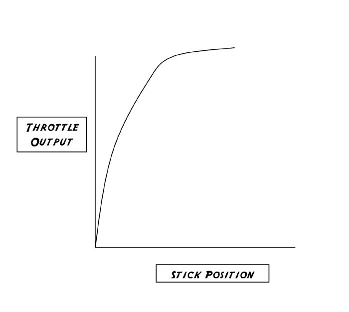

Does anyone use a throttle curve to "linearize" thrust versus stick position, given your particular turbine's thrust vs rpm curve?

Hello,
Yes I have used a curve, and they look like this:

Thanks for the reply Matt. I feel more comfortable knowing that someone has already resolved this issue with some simple programming.

I do and have been even since the early RAM 750 and 1000 days. I have 2 Rhinos and I set the mid stick to a value of approximately 1/2 the rated thrust.
