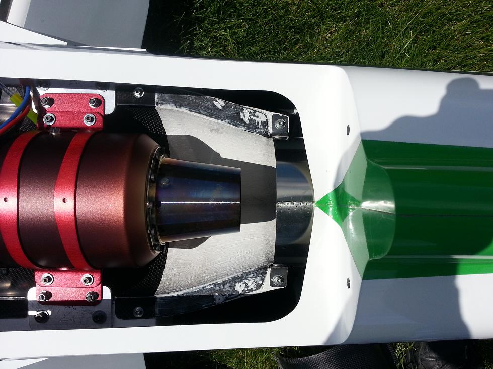

Hello experts,
I read through the KT manual and did not see any figures related to turbine cone - pipe gap. On a 210, what would be the min/max gap when installed in a carbon bypass? It's a Shockwave with a TAM pipe w/out a bellmouth. Read through the SW manual as well, no mention either, ...
thanks in advance for any help.

1/2"- 1"

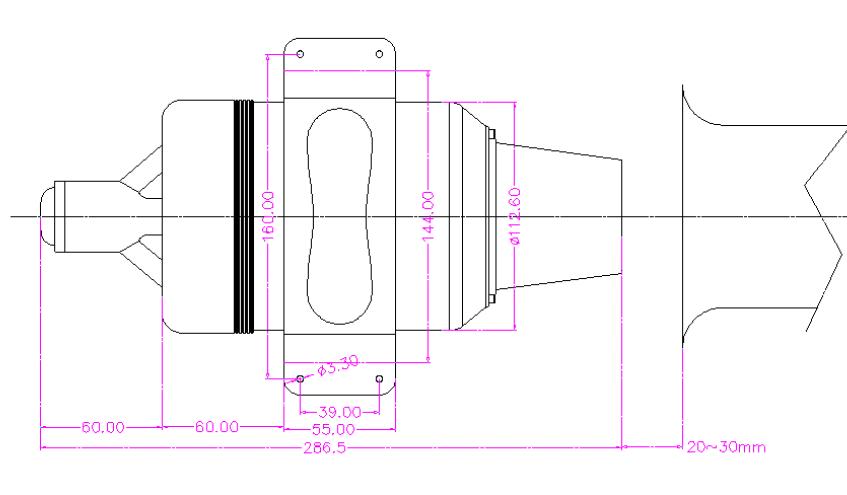

I'm running 1" (25mm) on two Shockwaves with zero issues. Kingtech manual (pg 44 in 2014 manual) shows 20-30mm, I just split the difference using 25mm.
Thanks, Scott.
