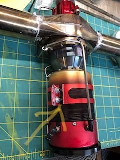

Hello,
I have 3 flights on my kingtech 45-tp and noticed rear mount cracked at factory bend. I was wanting to buy another
but couldn't find on pacific or kingtech websites. I'll attach flight and pic of mount. Is this common? This is
my first turboprop but have k45 and k85 in other jets.

I have one 45TP and 5 others KT none ever crack....contact pacific they have them in stock...

Thanks Dirk replied by email already. I thought it was very odd as this has been the only mount that's ever broke on me period.
He suggested tightening the front mounts first leaving rear loose and then tightening them. I can see that as a potential for causing the issue.

I see what you did, for sure that’s the way I mounted mine, and I’d required a little shim at the back on both side.
