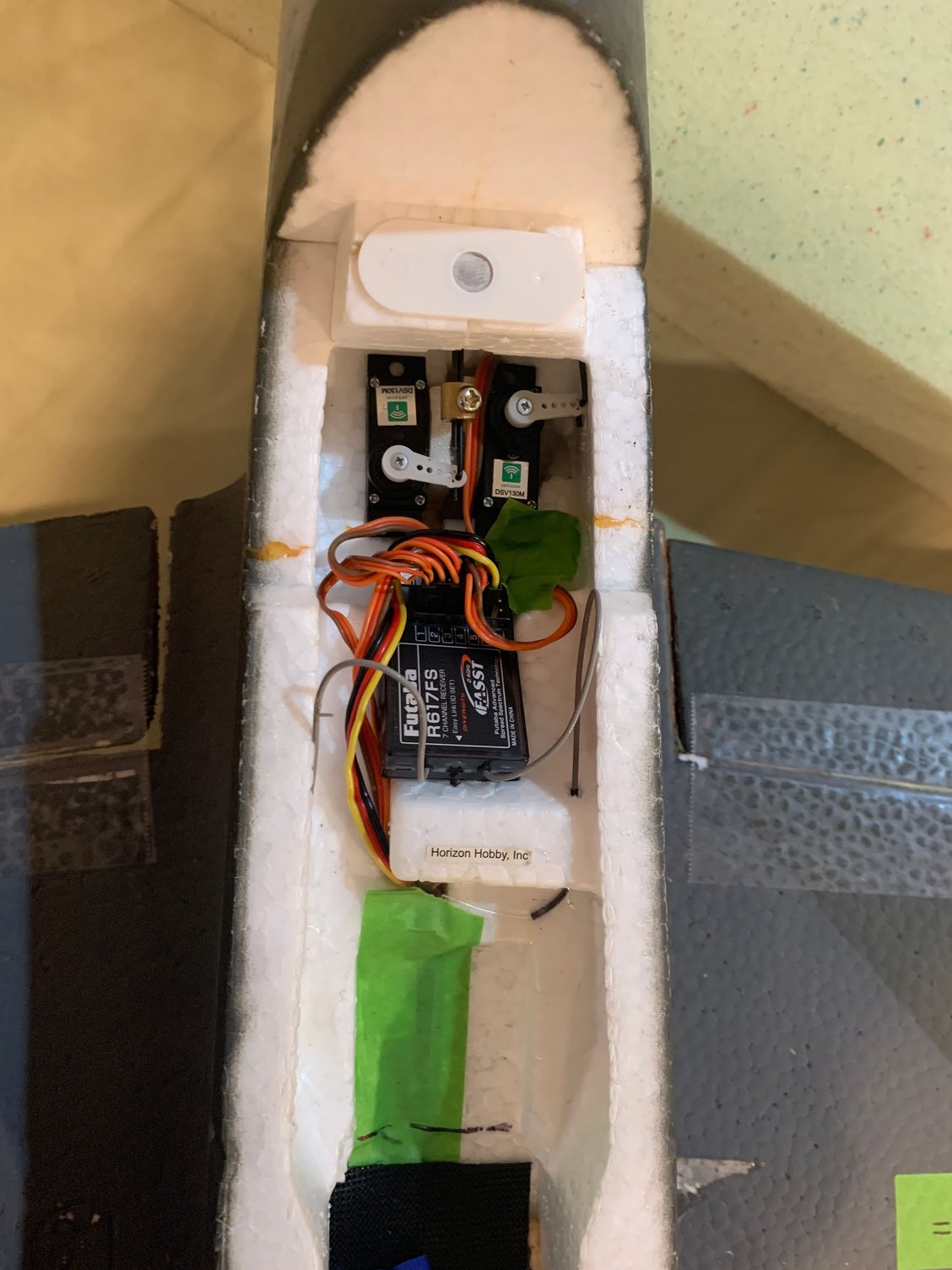

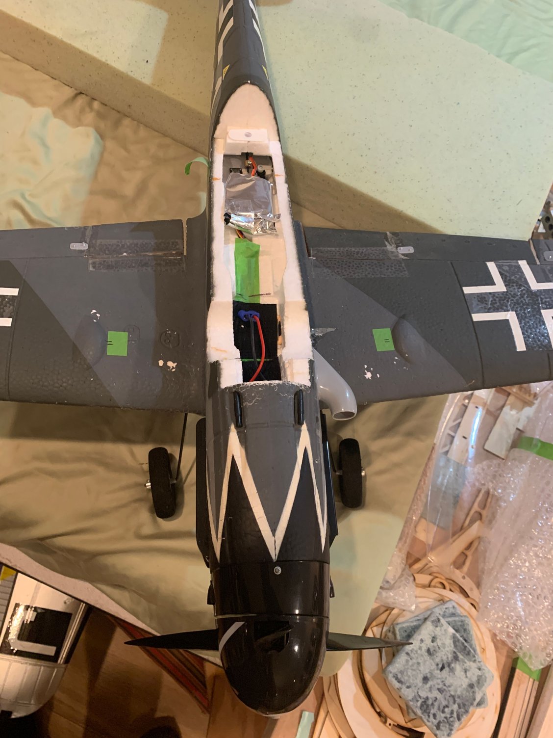

This thread has lots of thoughtful,varied opinions. But who is right? Time for some hard facts from actual flight tests today
I enclosed my Futaba 617 receiver in 3 layers of Ultracoat chrome Including both antennas Like Monocoat chrome its plastic (mylar) not actusl metal . Six flights including aerobatics and long distance
no problems-- not a glitch
here are the after and before pics Parkzone 109
