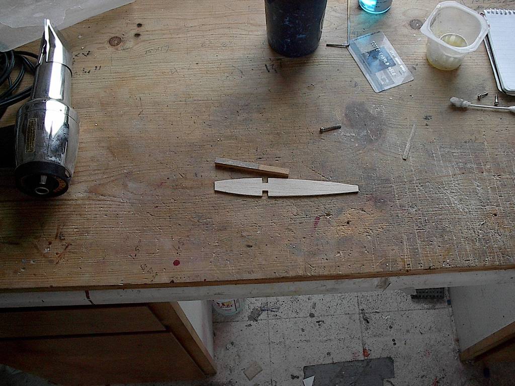

Gray Beard, how do you cut the notches in the wing ribs. I have tried a couple of times to cut a rib for a wing that had a damaged rib or two and they always turned out looking like a drunken rat chewed on the rib to emulate the notches.

I cut the ribs at least two at a time on my scroll saw, up to ten at a time if it's a constant cord wing. I use contact cement to glue down the template and give a light score with a exacto knife on the top line then when I cut the two sides with my saw the spar notches just pop out on there own. If not then I just make small cuts on the two lines. I have spar wood that I have sanded and glued sand paper to so it is the correct size of the spars and run that into the slots for a clean finish. Last step is to use my sander to finish the shape of the ribs. With the template still glued onto the ribs I sand them until I have gone into the outside line by about half. If you need photos to make this clear I can cut a few ribs and take pictures. A scroll saw and belt sander are the main tools needed for a plans builder that cuts there own kits. Other builders like band saws, it's just a choice thing.

Gray Beard, I understand it all except for the spar notches popping out on their own. What line do you score to achieve this?
EJWash1, I didn't read every word on the site, but I had the impression these were full kits, including wing ribs. No?
It's a bit hard to discribe so some photos are easier for me. If you look in the Model Airplane News plans section you can find a few pattern planes. I can't cut foam so I never bothered with the Curare but there is a very nice Atlas there.
I pulled out a paper template for the stab on one of my Daddy Rabbit builds and cut a rib. I was in a rush so I just used some photo mount spray to hold it onto the wood. A thin score with a blade or you can cut it out by hand if you like. I cut the rib out on the scroll saw then cut the notches for the spars then sand through half of the black outside line. When I have them all cut I use a piece of spar wood with sand paper glued onto it to get the finished size. It takes me a couple of hours to cut my own kits from plans. I order my wood in bulk from Lone Star Balsa and usually double the order so I end up with a lot of extra wood in my shop. My Daddy Rabbit cost me nothing because I had all the wood and hardware from builds in the past. By building from plans I also fly planes no one at the field has ever seen, I get a lot of those WHO BUILDS THAT questions from the guys, everyone seems to think the only planes today are ARFs.
