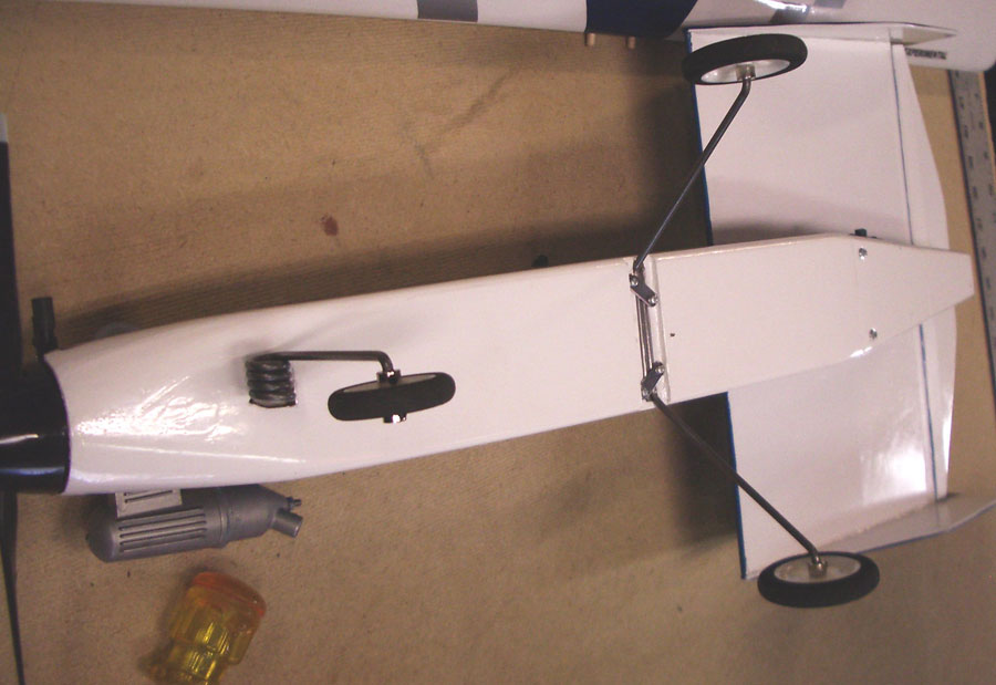

dash008, Your pics are great, but the plane covers up the plan! Could you provide a pic of the plan of the wing attach area? I need to build one of these wonders one day!
#27
I have one that I flew quite a bit but it is now in long term storage. More projects, you know! Anyway, I always thought it would be neat to lengthen the fuse just a bit aft of the wing so the battery could help the CG , attach more robust vertical stabs(maybe even rudders) and use something like an OS 46AX.

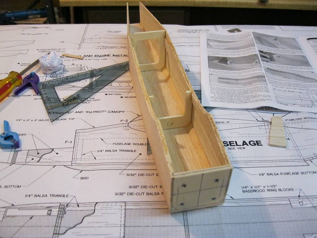

Working on the wingtips... I nearly chickened out on the fancy wingtips, and then I decided to "man up", so I am doing the concave wingtips after all. One of the blocks seemed a lot heavier than the other... I didn't like that.
The first two pictures shows the blocks glued on. The third picture shows the top of the wingtip after hitting it with the razor plane, and the fourth is the top of the wingtip after initial shaping with 80 grit. Still a lot to do but it is starting to take shape. I need to rest my hand because it is tired from all that sanding and I am covered in sawdust! This is too much like work!

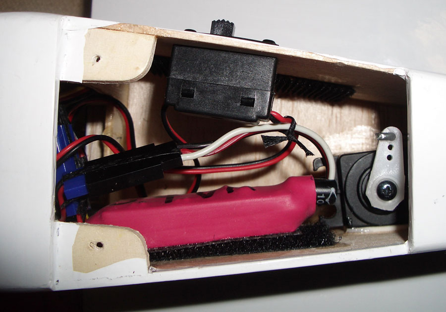

I need to get a receiver for my Wonder. I'd like to find a smaller one if possible. In all my other planes I have the full size 8 Channel R168DF. I don't need all those channels. 4 channels would be enough for this one. I have a Futaba 72 MHz transmitter. Anyone have a suggestion for a small ( full range) Receiver?

I don't know 72 mHz Futaba stuff that well but in 35 mHz they do make small receivers. I've gottwo 6 channel ones and they are ok.
I've tried to fit a JRSPEKTRUM system (2 reciever system) but the WONDERis too small for it, so I went back the the 35 mHz receiver.

I had a heck of a time trying to put a Hitec full size RX in this little bird so I gave up and put in a 2.4 RX, quite a bit smaller. I know I used up valuable space with my landing gear blocks and adding a steering servo. Also, I never could locate a suitable battery so I went with an experimental (for me at least) LiPo setup with a voltage regulator mounted in rear compartment wit switch and elevator servo. The 2 cell LiPo was small enough I was able to put most of it under the tank, I think it is an Electrifly 1100 MAH 7.4 Volt. I also added a home made servo saver to the little HS-55 for the nose steering. By using the Lipo and an HS-55 for throttle I was able to stay at 22 oz and change for final weight. I am intrigued with the Sloper idea from Bundubasher, these are neat little airplanes and i was thinking an electric version would be cool too. I am happy with how mine performs as is and might yet remove the fear to see if she is a bit faster. Mustang that is a great deal on that radio! I put some pics for reference, the red thing is the voltage regulator in the rear(very light btw). Good Lord! no idea why the pics are so huge! never had that problem before!
