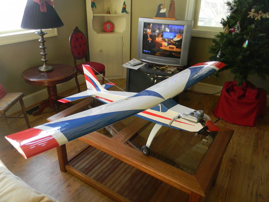

Goin' well, I think. Just hope it is sturdy enough. I've included a couple pics. First is the plane, it's a Lucky Star 40 ARF that I won on eBay for $32. I know the covering needs some attention but actually the plane went together fairly well and you do get what you pay for. I've been out of the hobby for a few years and want to get back to it but don't have a lot of $ right now. You can see I epoxied a piece of mohagany to the bottom of fuse and drilled a small hole all the way through the fuse. I ran some wire up thru the hole, bent it and epoxied it into the rudder. Not sure of the wire diameter or any dimensions for that matter I just eye-balled everything. What do you think ?
Scotty

Here is the finished plane!! I've tuned the engine ( OS 46LA), checked radio function, throws and CG. It's just been too windy and cold here in Maryland for a maiden. My only concern is that manual calls for 10mm up elevator and I can only get about 7.5-8 and have tried everything I can think of to get a little more but it just won't go.

It looks great, but you ought to take a heat gun to that covering before the maiden flight

I do appreciate the advice on the covering but I'm more curiuos what you guys think of the tailwheel I concocted from heavy wire and pushrod connectors?

My concern is, did you glue the wood to the covering material or did you strip the material off and then glue the wood to it.
Tail wheel brackets can be purchased for a couple of dollars, well maybe 5.
does your wheel have a tendency to wobble? If not, you may be ok.

yes I did strip the covering before gluing the wood to the fuse. The wheel seems solid sitting on the ground when I shake the plane a little. I'll let everyone know how the maiden goes as soon as I can fly it.

Concerning your tailwheel ___
Now that I have maginified the picture I can see the little fitting you have with a set screw against the plywood.
I just think it would have been preferable to have an aluminum flat washer against the plywood and a wheel collar instead of what you have. It would present a flat surfacee against the washer to carry the bumps of the runway or in the event of hard landings.

That is smart. I should have thought to put a washer in there to protect the wood and spread out the load a little. I do have some wheel collars so I'm gonna go see if I can change it up. It may be dificult to move the fittings around the turns in the wire but I think it is worth the try. Thanks !

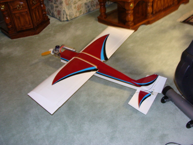

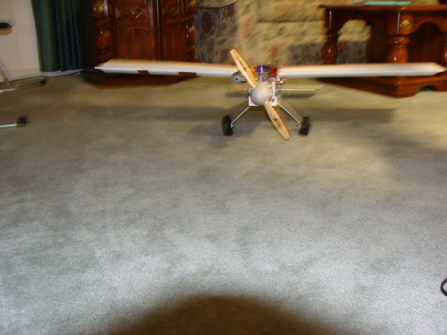

I did this one...It isn't supposed to be a tail dragger....Flies nice....fast too!
