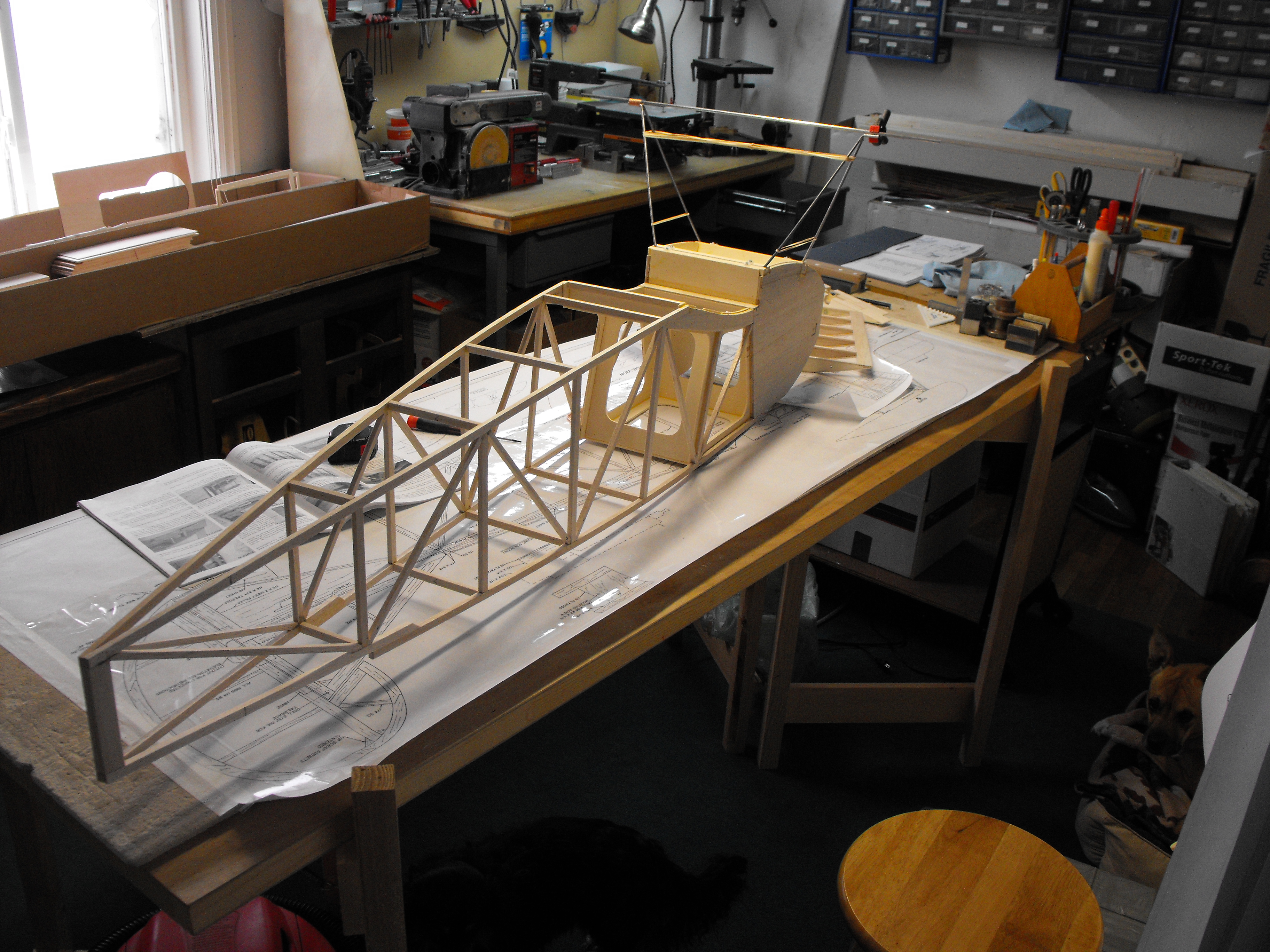

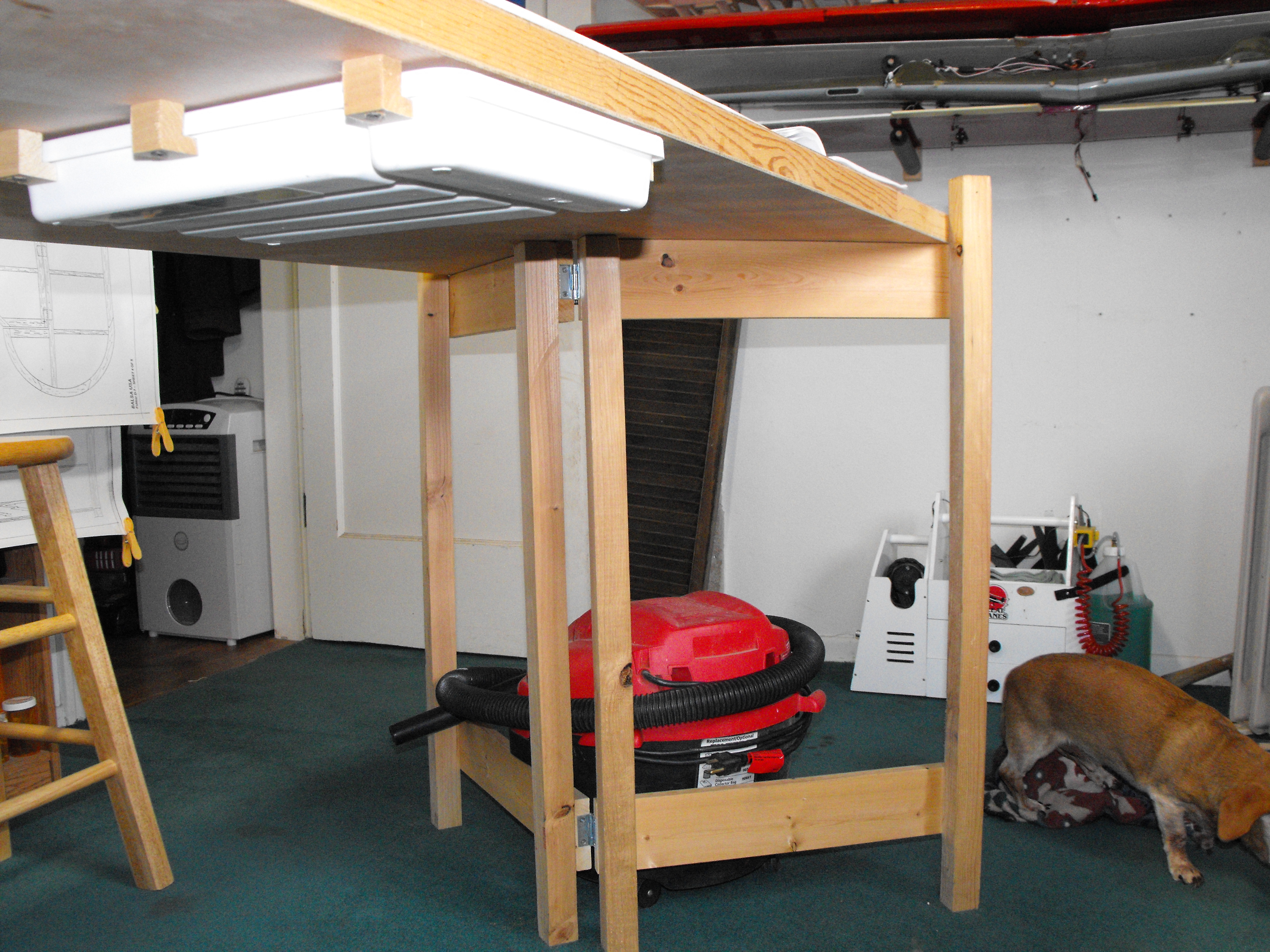

Here is a drawing and material list for the table support I use
it will fit a door core that measures 28X80''
It folds up easily out of the way,I put 2' X 4' ceiling tiles on top
