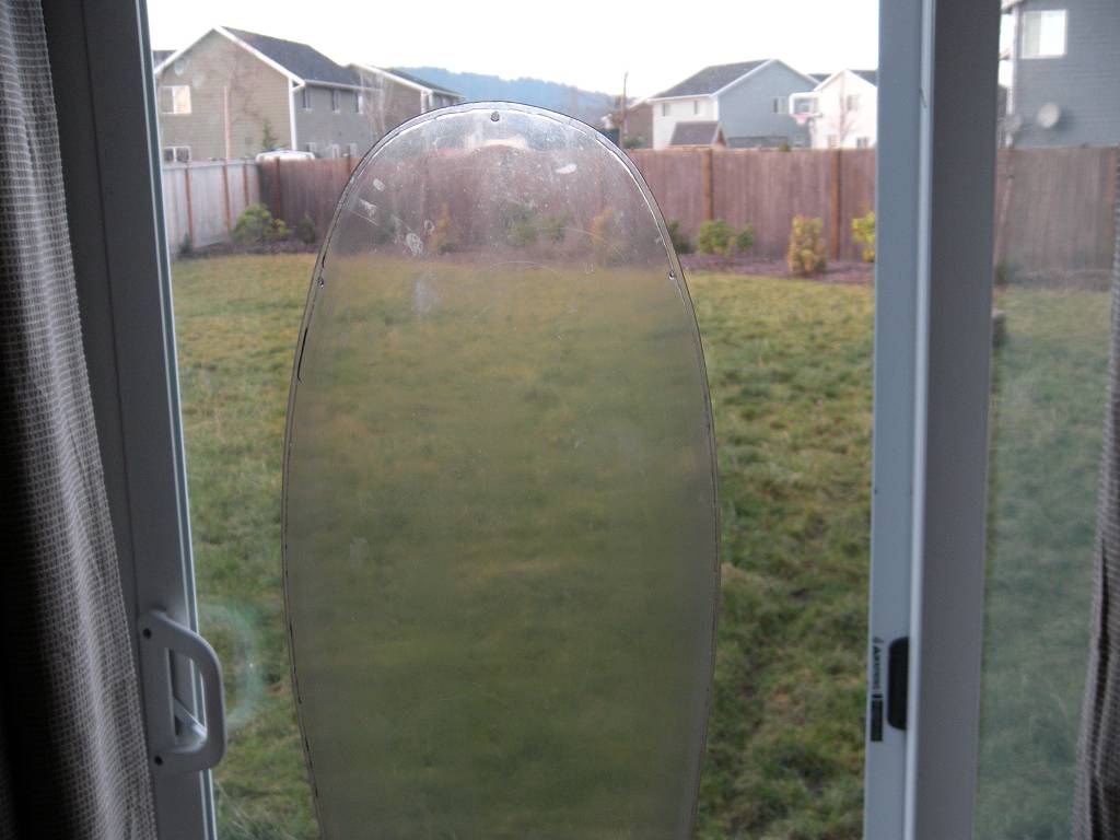

<span style="font-family: Comic Sans MS">so the canopy for my RV-4 is jacked up and i would rather tint it than paint it. here is a pic of it. i tried different soaps and car waxes and can't get it to look any better. does anyone know of something else to use getting it nice looking again beforeI go painting it? i'm sure in it's current condition that if i try tinting it, it's going to look the same, only tinted. i'm about to switch over to ********* if they don't fix this stupid server issue with uploading pics. this is the 4th time i've tried to do a post and it won't work. well, i guess no pics of it. it's all crappy looking like someone took steel whool to it. but no scratching. i wish i could show a picture of it. THANK RCUNIVERSE!!!</span>

Is it hazy or scratched? I spilled Acetone inside a canopy causing a nasty section of haze. I polished it back to clear again with a 3M Headlight Restoration Kit.

The 3M even removes scratches.

<span style="font-family: Comic Sans MS">i guess it's more like a haze. i'll try another picture of it. i didn't spill anything on it. it's been sitting in a drawer away from everything. what's this 3M polishing kit you are talking about? is it the one you use to get the milky look off head lights? one of my buddies told me about something like that a couple of years ago to use on my truck for that reason. i couldn't remember what it was called. i'll see if i can find one and give that a shot, cuz i really don't like painting them. i painted the canopy on my Messerschmitt solid cuz i jacked it up painting the framing. NEVER AGAIN. though it doesn't have a pilot, i still don't like it. thanks for the 3M idea. holy crap, i thinkthe picsworked.</span>

Looks like hanger rash from getting moved around in drawers too much. Yes the stuff is found in the auto parts store. Works good for a number of things so it's nice to have on hand. Even works on head lights!!
