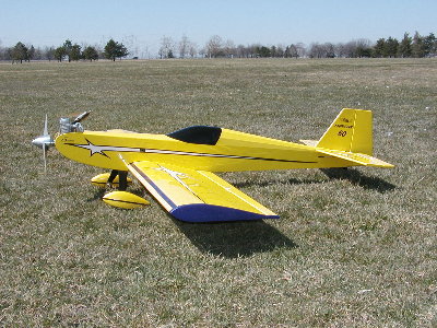

While I didn't sheet the wing, I with I would have. If you fly off grass fields, chances are you'll poke some holes from twigs and the like. What I did do is clip the wings by one bay, enlarge the rudder (alot - tapered 1" to 2" extension) and used wheel pants and canopy from a Venture 60 - they just look better imho.
Good luck,
Harold
Old 04-11-2002 | 02:38 PM
Posts: 128
From: Fredericksburg, VA
Default better view of the rudder
Rudder
