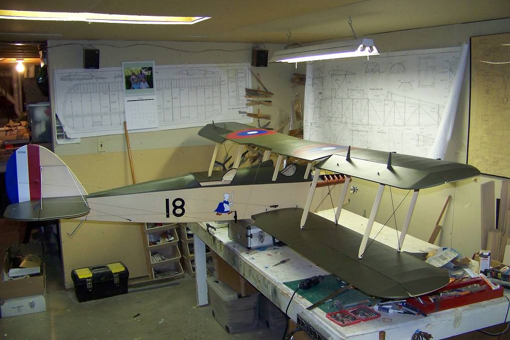

I have just about finished building one for one of my club mates. Only mods are to fit pull-pull control linkages on all the surfaces with horns in the scale locations. Also put lots of wire rigging on the wings. Kit parts fit was excellent. Suggest you inventory the die cut parts when you locate them on the sheets as recommended in the book. You will only need 9 sheets of the main rib rather than the 10 on the instruction inventory. You will need more false ribs than on the inventory. This may have been corrected by now. Our kit was one of the first batch and I have advised BUSA of the discrepancies I found. And they were very quick to make up the shortages. I would also suggest sorting bass wood vs balsa and sorting sticks by length. Makes it easier to find the right piece. I had some balsa blocks in the wing parts bag that I never did figure out where to use. BUSA plans tend to distort due to them being Xerox copied. Make sure you use a square to get the wing root ribs perpendicular to the spars or you will have to fill a gap when you mate the three sections of the top wing. Experience speaking. Did a few construction things my way rather than as in the instructions. Instructions are very good. We are using an RCGF 50 cc. Supplied muffler can now being shortened so engine/muffler/prop/radiator clearances will work. I have over 250 hours on the job at this point. It has been enjoyable.

Great looking Model. I sure do understand about BUSA plans, I have ran into that before and it is very much worth mentioning for those who have not built a BUSA yet. They make awesome kits but as with any kit there is a hick-up there.
I really like your USMC version from 50th Aero Squadron. I myself being a Former Marine am planning on doing A USMC Version from Squadron C Northern Bombing Group. I noticed you stayed with the Early Airframe. I was hard pressed to find A USMC Bird in that version. I am planning on changing the Fuse to resemble the DeHavilland 4 D1 used by the USMC. I will need to Square it up however will not strech it and will keep the tail moments as designed. The Rudder will also have to have a new profile. I have also decided against the Laminated Longerons. I ordered Spruce in the Finished Dimension from Aircraft Spruce and Specialty company co.

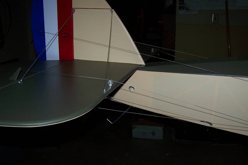

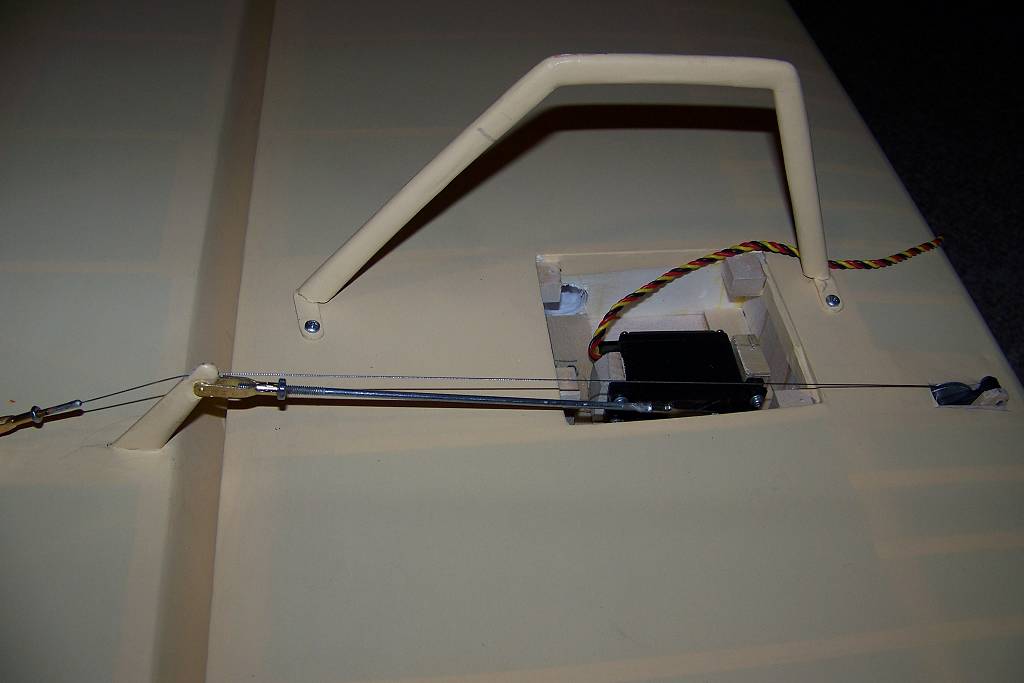

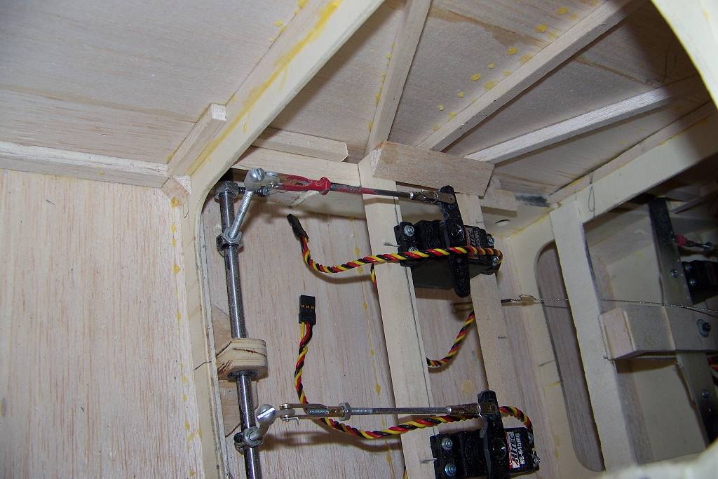

I tried to duplicate the geometry and horn locations for the DH-4 pull-pull, but didn't get carried away with duplicating the exact scale shapes. Our intention with this model is to have a good looking plane for our club's big annual airshow. It wasn't practical to replicate the entire aileron control setup so I used "faux" rigging there. A servo drives the lower aileron with a pushrod and then a closed loop cable system drives the top aileron. There are pulleys at the leading edge of the wings to route the cables.
First photo shows the elevator drive horn and the end of the rudder tiller bar. The elevator cables cross and the up cable goes over a pulley on the stab leading edge. A shot of the aileron pushrod. Dual elevator servos. Rudder servo and tiller bar.

I sure like what you have done with the control cables. I had the same Idea in mind. With all of the research I have done into the various models of the DH4 I have yet to come across good drawings of the cable routing. Your pictures will help a great deal. Are you using Proctor Pulley's? If not what did you use?
