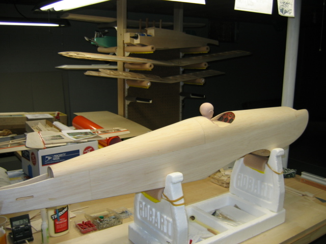

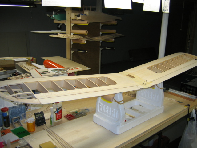

emilsanto, yes the parts for the Astro-Hog were all cut out of balsa and plywood by me using my old Dremel Moto-Shop saw. Most SIG kits are "glorified" plan builds anyway (and I mean that in a nice way) so the information for building is there on the plan for you to use. I've included some photos I just took in the shop of the framed, dry-fitted, Astro Hog to give you an idea of what you can do. If you have a couple of builds (not ARF models) under your belt you can most likely scratch build, though I'd shy away from the Astro Hog Bipe as a beginner scratch project. There's a lot of work involved and the rewards can be a great flying RC model that you constructed yourself from a pile of wood. The photos will show you what can be done without a kit. I made this plane into the taildragger version and did order the wire gear from SIG.

<span style="font-family: Comic Sans MS">wow... i haven't seen any one 'pin' hinges in a long time. nice job on them and the... astro hog? i built a rich urivitch extra 3.25 from a set of plans. the thing is a speed demon with a .32SX. plans building is definitely the way to go after all the kits turn into ARF's. </span>

Thanks for the kind words, crash. Been using the pin method (they are round wooden toothpicks) for years without anything shaking apart; takes a bit of extra time but no worry about control surfaces parting ways [X(] .

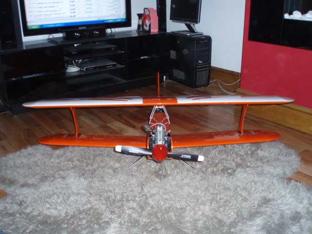

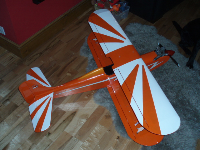

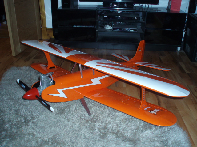

Here is my hog bipe, almost done. Started it last march, left it for six months in the summer, and just finnishing her up for the new season. Looking forward to the maiden in the next month or two.</p>

<span style="font-family: Comic Sans MS">very nice job. that your pilot? not really scale... </span>

orange always looks good on a plane and shows up VERY well in the air! your plane looks great!!

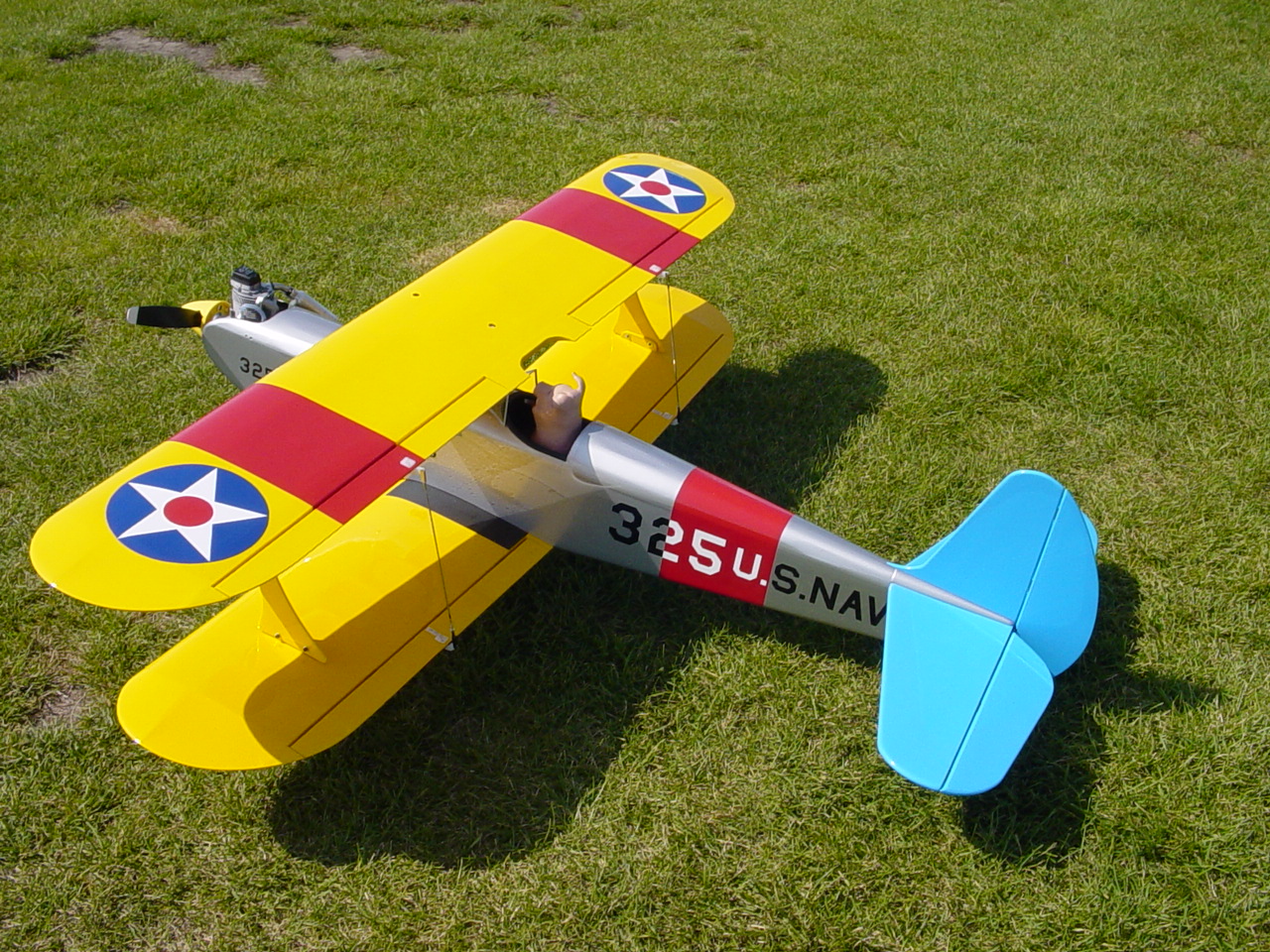

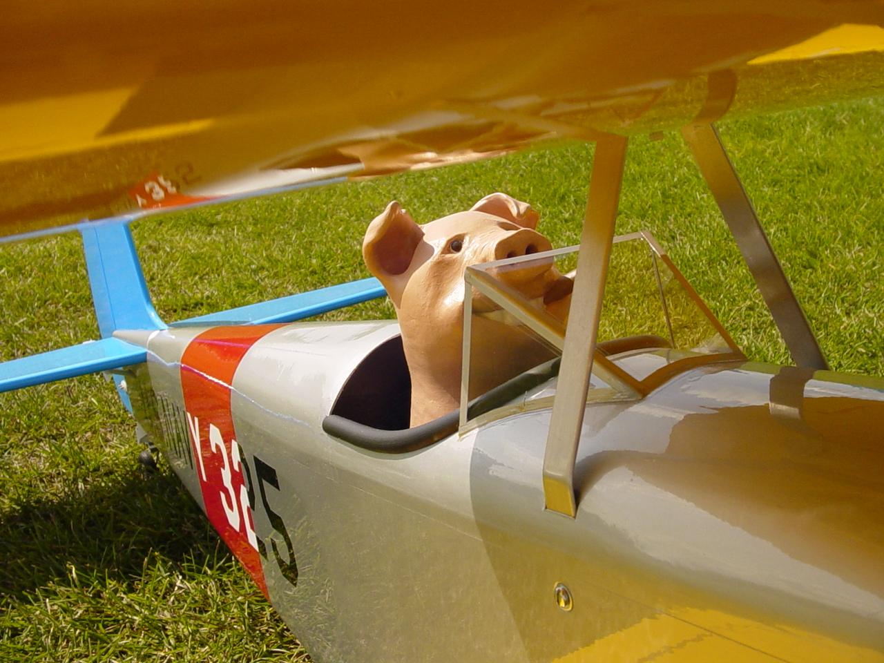

I have had both planes for a while now, each has a four stroke 90. The old Astro Hog has a larger wing and lighter loading than the bipe version. They really are two different planes with the older low wing plane being more like a trainer than the biplane. The Hog Bipe is really a pig and lands a little like one. Although I enjoy the heck out of the bipe, I found that its higher wing loading requires a little more speed on landing and still sometimes it just kind of flops down, you know what I mean. Solution was a Dubro fiberglass landing gear. The bipe is a blast to fly with the extra drag making it a not too fast sport aerobatic plane. I know I will always have one in my fleet.

Gotta love it, a Hog off of the Enterprise, as per the blue tail feathers.
The one thing I can't make out is the side number. Is that 3-S-5? If I'm reading it right, the number designates a bomber from the Saratoga's scout bomber squadron second section. The red fuselage band designates the squadron CO, meaning the last number should have been a 1, rather than a 5. Now, with all that said, if I read the number wrong it just doesn't matter. Regardless, it's still a good looking bird

The squadron number is the first three digits of my AMA number, 325. This was my retirement gift from my fellow employees. When I built the kit, I decided to bash it into a sort of Stearman PT-17 and chose the colors accordingly without any attempt to make any more scale than surface outlines.
