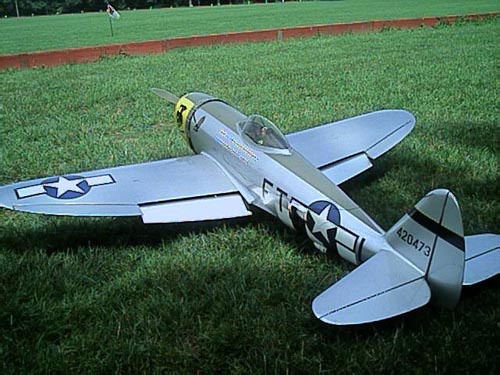

Old 08-10-2003 | 04:53 PM
Posts: 628
From: Barboursville, VA
Default Take a Look . . .
5 years old and still going strong!
Mark

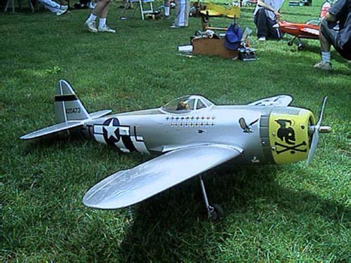

Old 08-10-2003 | 04:54 PM
Posts: 628
Default One more . . .
Mark
Old 08-10-2003 | 08:54 PM
FlyingPilgrim's Avatar
My Feedback: (26)
Posts: 1,504
From: Canton, MI
Default top flite p-47
Kram51,
Beautiful job!! I was planning on doing the razor-back version, but your bubble canopy version is sweet! Good inspiration for me to get going on mine. I love the looks of the flaps down. Thanks for the pics. I'm planning on putting Monokote w/ some panel lines. I'm not sure if I should use the panel line pen or use very thin stripes of Monokote cut on my striping cutter.
FP

Old 12-17-2004 | 08:55 PM
powertoys's Avatar
Joined: Jan 2004
Posts: 124
From: Everett WA
Default RE: One more . . .
Hey Mark,
I have a question about the trailing edge of the wing where the flaps connect. With the extra balsa pieces and parts of the ribs still poking through, how did you seal that area? Do you fill it all in and sand back to the curve of the rib ends, or just seal it and paint it, because covering will not iron in there without looking like crap. The directions don't tell me how to finish this area, and it is the first flap equipped plane I've built. Thanks.
Mike
Old 12-18-2004 | 10:11 PM
Posts: 628
Default RE: Take a Look . . .
Donnie-
Its the Top Flite 1/7 scale T-Bolt and it flies terrific!
Mike-
Yes the trailing edge of the wing at the flaps is concave to match the LE of the flaps. Its not as hard as you think to seal this area with iron on covering. I used the TF trim iron with the round shoe and after heating the material and pressing it into the wood I immediately followed that with a damp rag to help pull the heat out and set the glue. Works like a charm!
Mark
