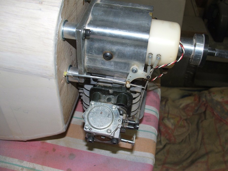

Unfortunately, if you've done what I think you've done, you did get ahead of yourself.
I'll bet that you sheeted the nose, before installing the engine's blind nuts. If so, you can still get to the lower blind nut locations easily, so you won't have a problem, there.
The top location is a different story. You'll need to remove enough sheeting, to give yourself enough room to install the blind nuts.
It's more embarrassing, than hard. Hopefully, the location will not be on the same level as the top ply plate. If it is, you'll need to open up more sheeting, to give yourself room to work, hogging out the ply area where the nuts need to be. When I mounted my Mag 1.60 twin, this was the case. I had the holes drilled, and blind nuts mounted, before I mounted the firewall. This made the problem easy to see, and much easier to correct.
This thread may be of interest , and provide you with a few ideas. http://www.rcgroups.com/forums/showthread.php?t=956429
This one may interest you, too. http://www.rcgroups.com/forums/showthread.php?t=1356049
Like I said, this really isn't hard to correct.

Tom I sure like the way you frinished your. I have not got the firewall covered yet. I am trying to figure out how to get the standoffs bolted to the firewall. I'm going to see if I can find some 5mmx3inch screws. More advise if you have it.

My standoffs are really just spacers. I had them made to my required length, and drilled to accept #10 bolts. The bolts simply pass throught the standoffs, go through the firewall, and screw into blind nuts mounted to the back of the firewall.
I purchased my 10/32 screws and blind nuts at Ace Harware.

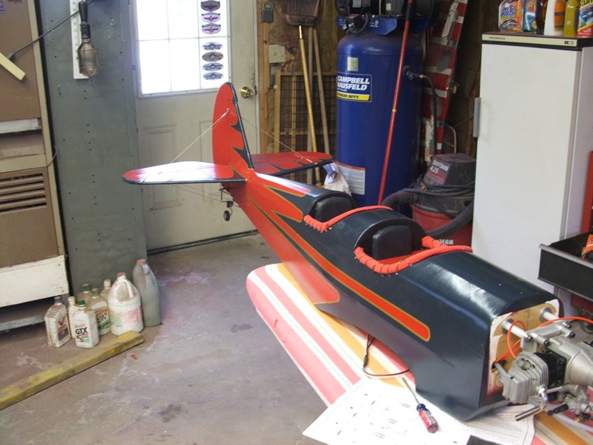

Both of my Spacewalkers are covered in Solartex. The SW II was painted in Nelson Hobby Specialties paints, using no dope or primer underneath. ( glass parts were primed)
The 1/3 SW will be painted, using Rustoleum. Again, only the glass parts will get primed.

The pics of the engine mounting, (in the previous post) are of my 1/3 SW, but the principles are the same for the quarter scale.
On the 1/4, I used nylon (?) spacers, also from Ace Hardware. The bolts slip through them, and into the firewall mounted blind nuts.

Tom I couldn't see the forest for the trees. After your help I just drilled the stanoff out and went with the 10/32 screws. I don't have to cut out for the carb the stanoff are long enough. I haven;t got to the linkage are the plug wireing yet.Once again any advice will be helpful. I'm studying on the finish Solartex and paint.

On my 1/3 scale, there is no room, in the engine compartment, for the ignition or battery. I haven't installed them yet, but I imagine that they will be mounted on the interior side of the firewall.
There's plenty of info about Solartex, on RCU. For scale models, it is my covering of choice. I find it to be easy to apply, and it does not require all the work of, say Koverall. You can paint it with almost anything. I don't even use a primer. My 1/3 SW will be painted, using Rustolem, in quart cans.

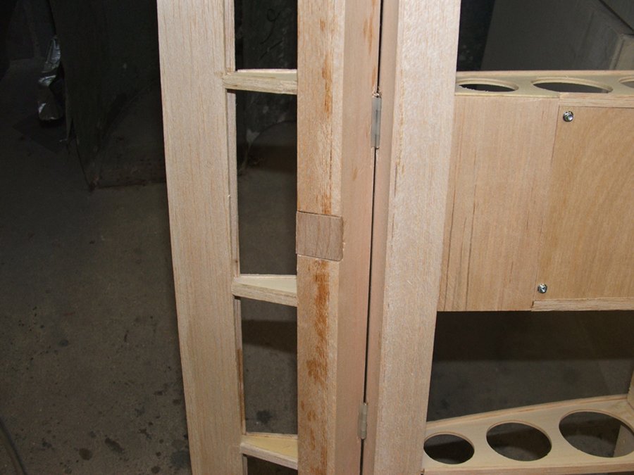

Old 03-12-2011 | 04:55 AM
My Feedback: (7)
Posts: 779
From: Durham, NC
Default RE: Another Sig Spacewalker II
Tom, I assume you slotted the surfaces with the opening at the top of the bevel and angled them down. Is that correct?
Brian

From: Traverse City, MI
ORIGINAL: fireman7875
Brian
Yes. That's exactly what I have done.

<span style="font-family: Comic Sans MS">is this what you have done with the ailerons? i can't tell well by the picture, but this is how the ailerons on my sig SMP are designed and built. should i redesign them to be 'normal', or are they going to be okay aerodynamically with that big open area under the bottom? i'm assuming it would be fine since it was designed that way, but would 'normal' be more efficient?</span>

That is exactly what I did with the ailerons on my Cub using hinge points. The biggest difference between the hinge point and flat hinge installation will be the amount of shaping you have to do to the opening for the hinge and the difficulty thereof. There has to be room for the elbow of the hinge point in addition to the hole for the post. That makes it a little trickier to install than the flat pinned hinge. I will probably give the pinned hinge a try on my own spacewalker.
Brian

<span style="font-family: Comic Sans MS">don't the robarts only deflect to about 90*? that seems like a pretty shallow angle going into the surface and trailing edge. i'm probably going to use pinned hinges on my SMP. seems easier than getting the holes and space perfect to not look bad. how are the plans for the SWkit as far as templates or patterns for cutting your own formers if you wanted to build another one later down the road minus the kit of the whole thing? i would like one that was around the .32-.40 range.</span>
