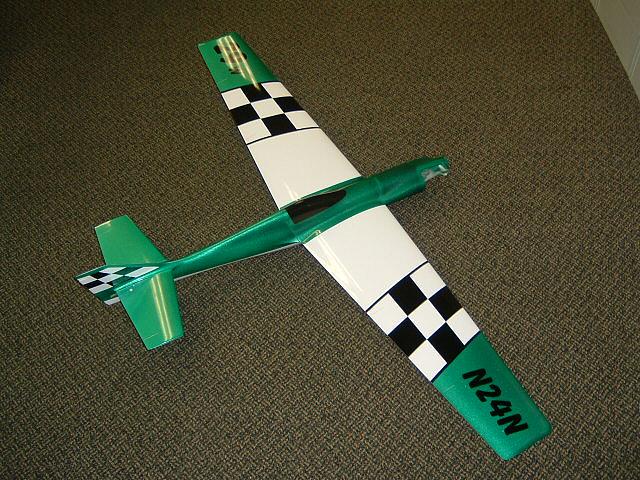

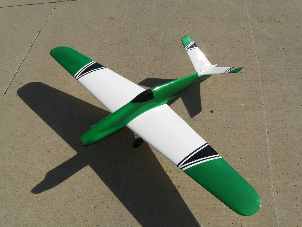

I have used mettalic paints for years with completely enclosed antennas for years (10+), both 72 mhz and 2.4 ghz.
Just do a good range check and you should be fine.

there is a ton of flake in that paint (PPG base coat clear coat) in there as well, no issues.

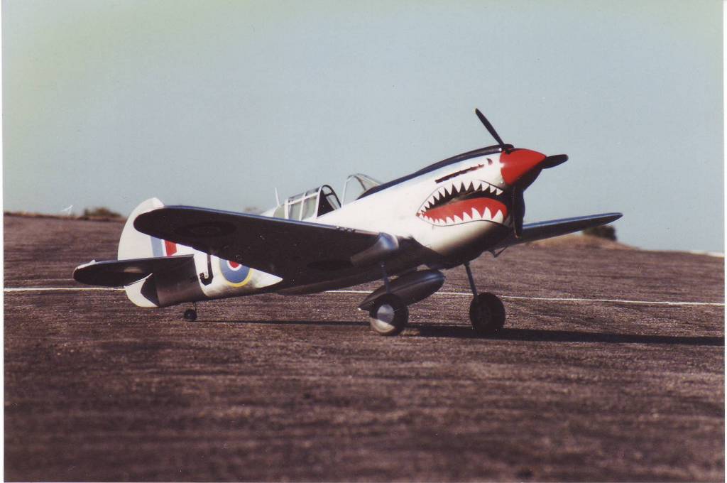

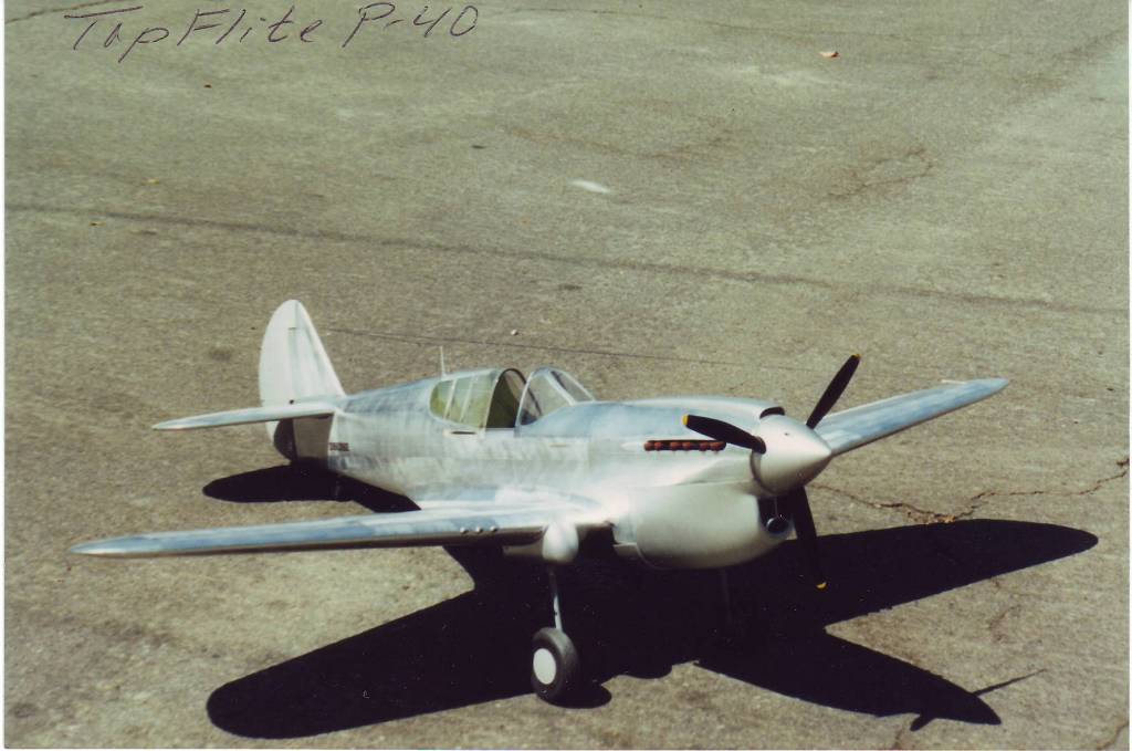

All arguments withstanding, I don't think you could get a paint much more "mettalic" than Chrome Monokote, and I never had any problems with this one.
Les

Looking at your nice pictures (beautiful airplane models) I have to assume that your antenna(s) areinside the metallic Monokote but you did not say so.
Zor

Antenna is about 75% inside, with only 25% exiting aft of the cockpit. The radio frequency is 6 meters (50 MHz). If there was to be a problem, I would have expected a much shortened range, (especially off the nose or tail) but it flew as long as I could see it. I do understand that being a longer wavelength that the 72, results may be slightly different, but I would expect the difference between the two frequencies to be negligable(sp). Perhaps one caveat, is the monokote is put on in panels, not one continuous sheet, but again, at these frequencies, I would not expect the RF to notice that.
