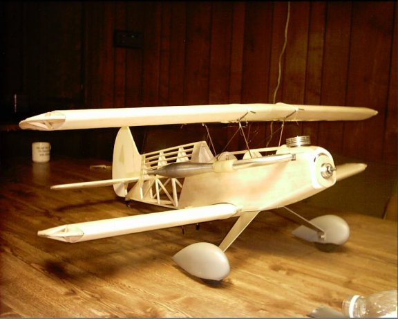

Default Pictures
Took some pictures of the one in progress. Ailerons are cut and fitted but not attached.

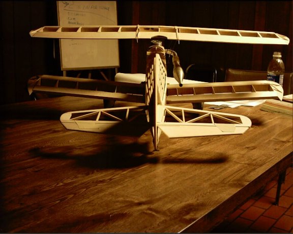

Old 08-26-2003 | 11:43 AM
MikeSell's Avatar
Posts: 822
From: Flushing, MI
Default Pictures
Didn't have the scale with me, will have to get that done tonite.
