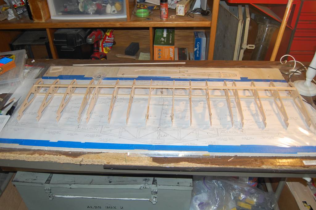

This is where it all started. fabricating the tail and then right into the wing. I thought I was sunk as soon as I saw those wing plans. I thought "well this is what's gonna cause the crash" I actually laid up the ribs and spars pretty quickly after a quick RCU search revealed what I needed to know.

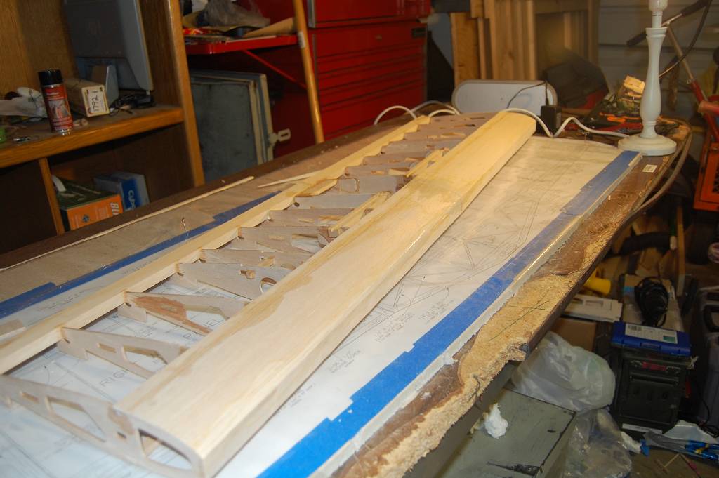

The wing went wayyyy faster than I thought it would, only a few nights and I was sheeting. I can't say much for the sheeting, had to edge glue pieces together, but that's the worst thing I can say for the whole kit. I think it ended up looking pretty good. (for a first timer) Seemed like each portion I did came out better than the last. the bottome of the right wing is worst, top of left wing is best. I learned as I went I guess!

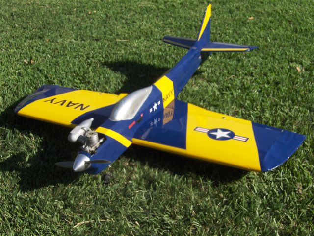

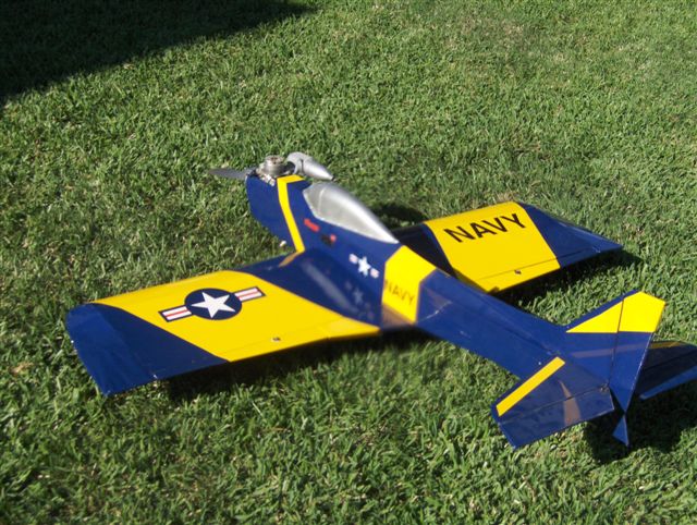

Nice work , i put flaps on mine and coast guard colors and i like it thanks frank

In no time at all, (it didn't seem that way) I had a wing! I did learn that a razor plane would have been a nice tool to have. unfourtunatly I didn't learn that until I had carved everything free hand with a #11 blade! Once again, I learned something! In the plans, there was an option for up turned wingtips, suposed to correct an adverse roll coupling issue. I decided to build the upturned tips, really, cause I liked the way the plane looked with them vice without. I'm very pleased with how well they came out. Both ended up at exactly 40 degrees as called for. (due to good plans and not great skill I'm sure)

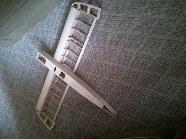

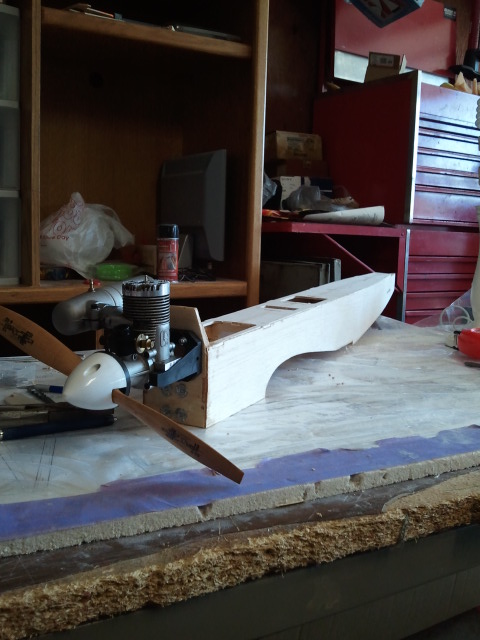

When I got to the fuse it went together quick and easy, so quick and easy I forgot to take a picture, othe than the in the livingroom floor when wing first met fuse.It seemed odd to mount the engine at this point, but being the newbie / follower of directions......and MinnFlyer, that article and your covering video's were a great "fill-in" for my lack of having anyone living near by, that had built a kit before. So in a way you taught my to build by proxy. (does that mean I can blame my mistakes on you? ha ha)

HB for power plant?
It looks like a HB with PDP and a ST muffler. If this is true you will be VERY happy with the motor (minus the muffler).
I'd like a contender myself, actually. Nice project.

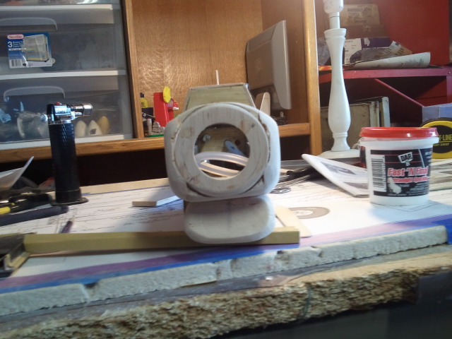

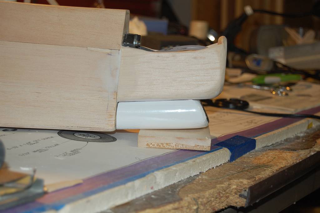

now that the engine was in place, I started with the cowling and the fake airscoop. These both were carved from balsa, a lot from the inside face had to be removed to flush these blocks against the fuse sides. the left and right were joined the front center with a supplied balsa ring and the rest was filled in with scrap. this was really a learning process for me.....on how to use filler!

That's exactly it, an HB .61 PDP. It came free with a ragged Hawker Huricane someone wanted me to get out of his way. He thought it was worn out due to the dykes ring feeling like there is no compression while sitting. I tore it down went to order parts and got educated by mecoa! The muffler was aslo a freebie, A friend had it lying around at random. Told me it if fit it was mine. I did have to order a carb from perry though as the old one was missing too many parts. Great engine though, just cant seem to slow it down enough to get her to STOP pulling planes on the ground.

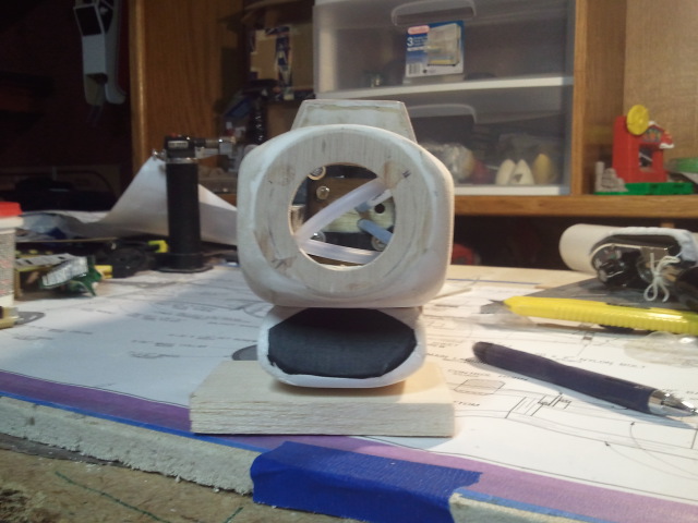

Now with the cowling carved it was time to attach the scoop permanently. I decided it would be easier to cover the scoop before I did that so out came the iron for it's first trip down anything not square and flat. One last search of RCU brought me to these videos, and I'm proud to report mediocre results. (as long as you stand back a few feet that is )

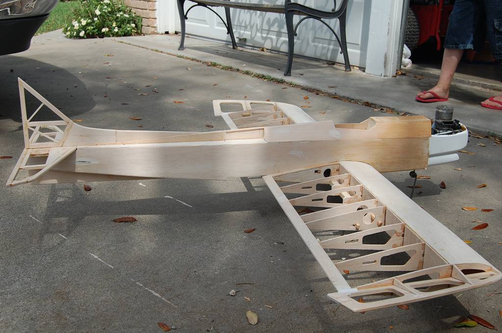

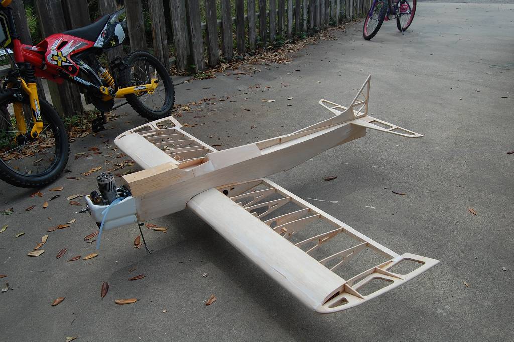

OK, just a few more pictures in the raw form, man I love the way a plane looks between build and covered. Wish I could just take them out and fly them like this. I bet I would work a bit slower and really try to make it look nice on the inside then.

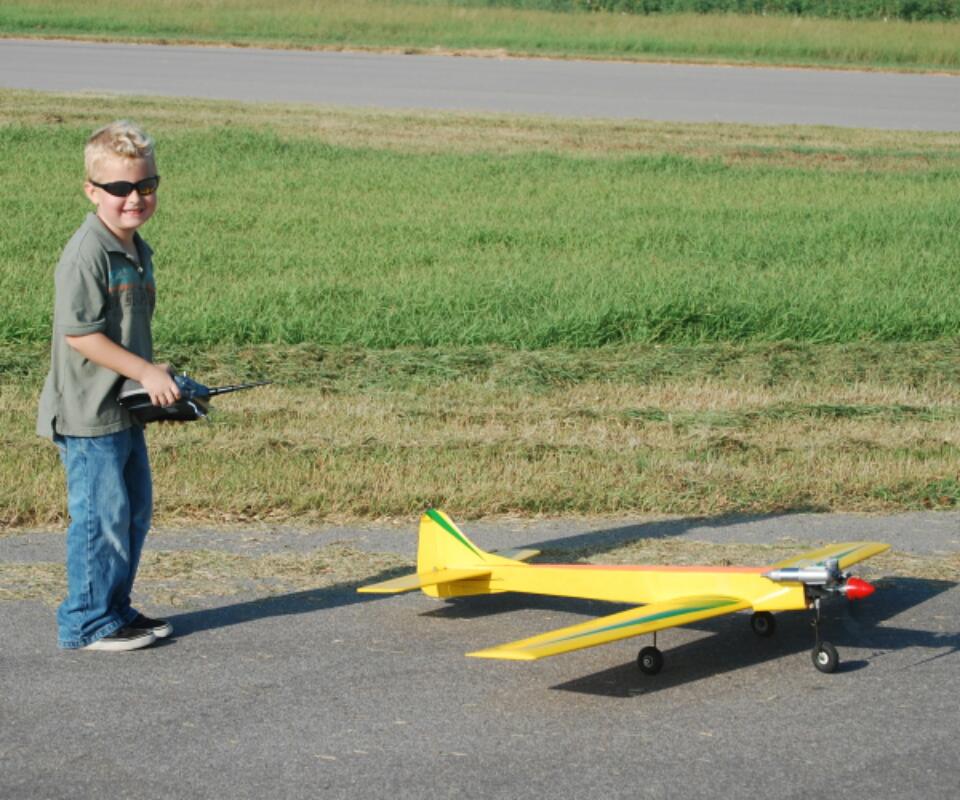

Hope you have as much fun with your Contender .60 as I have. A really great Dave Platt design from his days at Top Flite a long time ago. Here is a picture of mine. Using an OS 61FSR ABC and standard servos.
