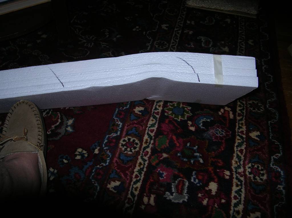

I have takes some pictures and progressed some but not too much. I have roughed in the retract mounts and carbon carbon spars as previously talked about. I just uploaded a picture of that.
I have the three balsa fuselage parts glued together and the ply doubler installed with polyester resin. The firewall is epoxied in place and the next two bulkheads are in place. I am on hold pending the balsa that I have ordered.
Retracts are ordered and once received I will continue with the wing and horizontal sheeting. I do not want to secure the spars or the retract mounts in place until I have landing gear blind nuts in place. Once those are installed I will secure everything in place.
I am debating with myself as to whether to use one or two servos for the aielerons. Probably two. Just have to come up with a way to tunnel for the servo wires.
Pictures attached, I hope.

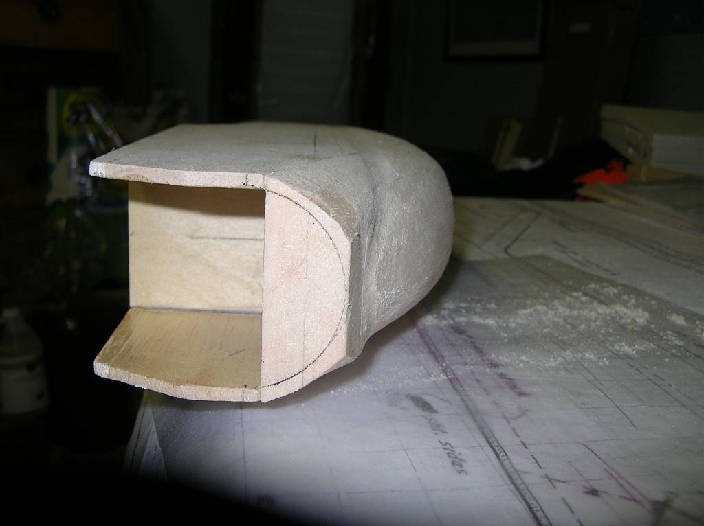

I have some more work done. I am sonewhat limited on time as my wife had elective surgery and I am acting as a nursemaid and house husband. I do not mind these tasks at all. They just limit my time at building some.
I have rough shaped the fuselage and a lot more of that fun sanding and shaping is yet to come. The fuselage as it is right now weighs 528 grams or 1# 2 5/8 ounces. The entire fuselage was assembled or glued in place using polyester resin. I do this because I feel the the polyester resin sands much easier than the c/a's or epoxy. The only epoxied part in the fuselage is the firewall. Trying to keep weight down. The chin plate has not been installed because I am waiting for a motor mount and need to set the down and right thrust. That will requrie the motor mount to be installed, so that is on hold.
I did have a mishap when installing the carbon fiber spars. I tried to use polyester resin and it ate the foam up so I ordered another wing half and will start that anew when it gets here.
The vertical fin is about 3/4 built. For me that means that it is sheeted and still needs to be squared up at the connection of the ribs and sheeting before proceeding. I have attached pictures of the fuselage, one before rough shaping and one after.

Jim,
looking good!
The only thing that comes to mind is with respect to the nose. I found it hard to shape the top nose blocks in the absence of the front block and nose ring being built before hand. Basically, the nose comes to a point (well, a 2.75" diameter) with the fuse sides arcing inward rather sharply in front of the firewall. If you have kept the fuse sides parallel to the nose ring at the width of the firewall, you should be able to obtain the desired shape by using some 1/2" or 3/4" tristock in front of the firewall and sanding to contour of the nose ring block. You might also need some tristock up against the nose ring block to fair the nose into the spinner. In short, the top blocks were the last thing I did but there are many ways to go about it so I'm eager to see your progress.
Watch any polyester resin and CA on foam - I guess you know now. I don't particularly like foam safe CA either as it gets guey and doesn't seem to dry (even with kicker) and it "strings". Epoxy in key areas (retract blocks, firewall, stab, foam sheeting) and wood glue are the way to go on these models for nice sandable surfaces. If you haven't done your wings yet, I like to use laminating epoxy (Z-poxy finishing resin is pretty good) for wing sheeting but polyurethane based glues are also used often (e.g., gorilla, elmers). You are probably well familiar with all this.

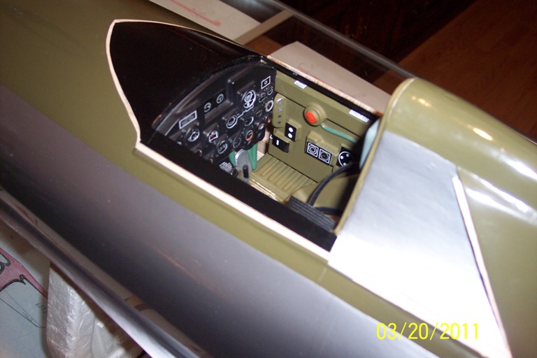

Terry,
not sure if your comment is directed at me (or at the little Tipo rather) but if so, many thanks. The Picorare was scratched with a foam wing and stab sheeted with 1/32" balsa and a built up balsa/ply fuse. Covering is all done with Monokote although the orange is Ultracote (and the blue is Ekonokote on the underside). Only the canopy area is painted in a metallic blue over scuffed white Monokote.
I am building a 60 size one too which will be finished in the same trim scheme. However, it's on the "slow burner".
Some mighty nice scale work there on your Jug too! What scale?

Jim,
glad the pics help. Looking at the nose, it appears to be glued to the top blocks at the width of the firewall. The tristock will not be sufficient to provide the material to contour the nose. I'd recommend using some balsa doublers in the cowl area from the nose ring half way back. You could use full length doublers but you might run into space problems to get your engine mount in. If the mount fits with the full doublers, I'd do that. Once the doublers are in, then use 1/2" tristock along the bottom, chin, front and top corners. It will be a little congested while you fair the nose in to the spinner but once shaped, you can then hollow out the inside as needed to fit the engine. Make sure you also back the nose ring with a 3/8" piece of balsa - sort of a last former if you will.
I use 24" sanding blocks on 60 size foam wings but they are a little hard to control with one hand. If the wing is held fixed, then you can work a long block with both hands. Provided you are working on individual panels, I find that even 12" blocks work. The longer ones are nice when sanding the prepared sheeting prior to attaching to the cores. Once it's on the core, I only sand it lightly with 220 grit or higher with a 12" block.
It looks like your nose ring tracing on the top blocks might be 2.5" diameter. I'd recommend using the 2.25" nose ring and spinner of the design - looks much sharper!
Here's a shot of a wood fuse. This one is scaled up to 2m but otherwise its the same idea.

RE: .60 size Pattern Tiporare Build
I have taken pictures of the rudder with the vertical fin and will post it.
I also received my replacement left wing from Eureka and thanks to the post office I will need another. I have a call into Don Turnock but no reply as of now. I will post some pictures of that also. Meanwhile I will just chill out a little.
The leading edge on the horizontal fins is almost at final shape. Not too much more I can do at the moment.
Jim
Jim
Jim,
what happened to your original left wing? That's a nasty bend in the replacement!
Hey, you could work on the fin tip! Stabs joined & glassed?
David.
David.
