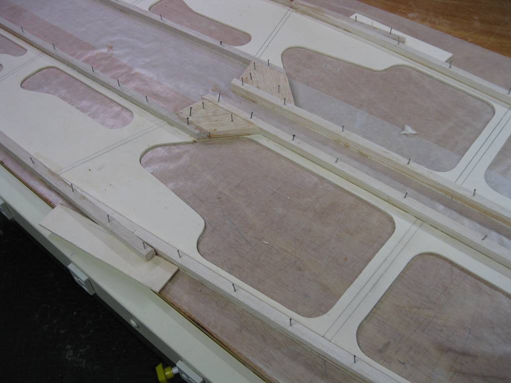

I use 19 gage finishing nails, just nail the parts to the bench surface ( Solid Core Door). I have difficult time with spruce, lite ply and a/c plywood when using pins. Sand down the bench and revarnish every other plane or so.
