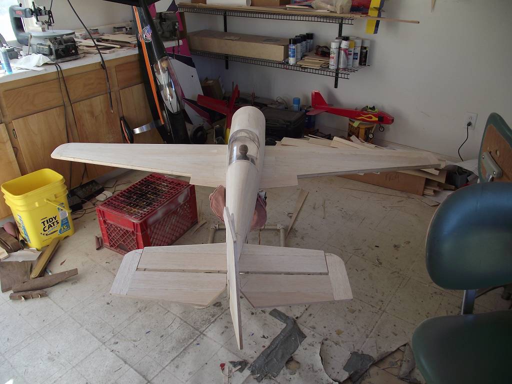

Want to know how that new plane will handle? Thanks to Gray Beard for sending this chart. It makes calculating your wing loading as easy as drawing a straight line!
Nice chart! Thank you for that!
And what timing, I was doing this just today actually, because I'm cutting my wings down to 24" each side. Yes, for a better scale outline.
OK, thing is this, and has been an ongoing question.
"Do you consider the "area" that's the fuselage?"
On some models, Jets especially, this can be considerable!
Here's a "chunky," just to show an example.
I have 8" of fuselage eating up my wing area! Actual scale would be 9".
Span, 48"
Root cord, 11.5"
Tip cord, 7.75
Fuselage thickness, 8"
I figured my Sq's out and I'll bet I'm wrong. Those four measurements will give you my wing area.
I could use the help, so what do you get?
Thanks in advance.
Charles

Hello avaiojet,
This topic of including or not including the fuselage in the lift area has been discussed in the past adinfinitum.
As I recall there was no definite conclusion reached.
The thead became one of "forum politics" more than analytical.
Some judgment has to be used based on the type of fuselage involved.
If the width of the fuselage is less than 10 to 12% I do not include its width in the wing span as one factor of calculating the wing area.
If the fuselage width is more than 12% but less than 25% I tend to calculate using both meaning with and withouot the fuselage width and compare the difference. It is often difficult to figure out if the fuselage has an appreciable lift factor. It can be either way versus the main wings.
When considering a "delta wing design" which, most of the time has a high leading edge sweptback I include the fuselage as part of the lifting surfaces. That seem to be realistic and make sense to me.
I try to evaluate the contribution of the fuselage part of the lift forces.
These days the power to weight ratio is more important than the wing loading.
Nearly all modelers equip their model with an engine/prop assembly that provides moe thrust than the the model weigh.
It is easy enough to calculate both ways using your posted figure.
I suppose that by "fuselage thickness" you mean the width of the fuselage in the wingspan direction.
When including the fuse in the area I would consider the chord of the wing to be the same as the root across the fuse.

All readers,
Span 48"
Root chord 11.5"
Tip chrd 7.75"
Fuselage 8"
Each wing has an area of 192.5 sq. in.
Fuselage has an area of 92 sq. in.
Total wing area NO fuselage is 385 sq. in.
Total areas WITH fuselage is 477 sq. in.
Take your pick _ _

I got 462 for total SQ's, not counting the fuselage.

Hi All,
Anyone kind enough to take a moment to point out my error ?
Zor
Zor,
Why are you so quick to think it's your error? I make mistakes too. Well.
I don't bother with that kind of "real" math.
I added 11.5 to 7.5 then multiplied it times the span then devided by two.

ORIGINAL: Avaiojet
Zor,
Hi again Avaiojet,
I first calculated in maths only since I had not seen a figure in the thread.
When I saw a different answer I went to software that can draw and calculate for me.
So I printed it, scanned it and posted the drawing.
I was not "so quick to think it was my error". It takes time to draw this up, print it and scan it to get a ".jpg" picture to post.
I am a "slow poke" .
