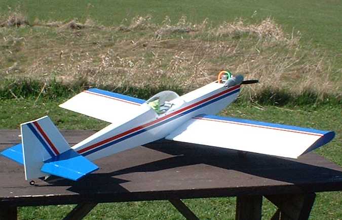

I also used the tri stock method. In fact I think the wood was included in the kit. I agree with Mole Hunter that dowls would be dificult to align and I do not think that they offer any benefit over the proposed tristock method.
You can hardly see the tristock in this photo. But definitely agree that it is better to cover before gluing to plane.

Wow! Lots of mods on that one. It looks like a different plane. Great work.

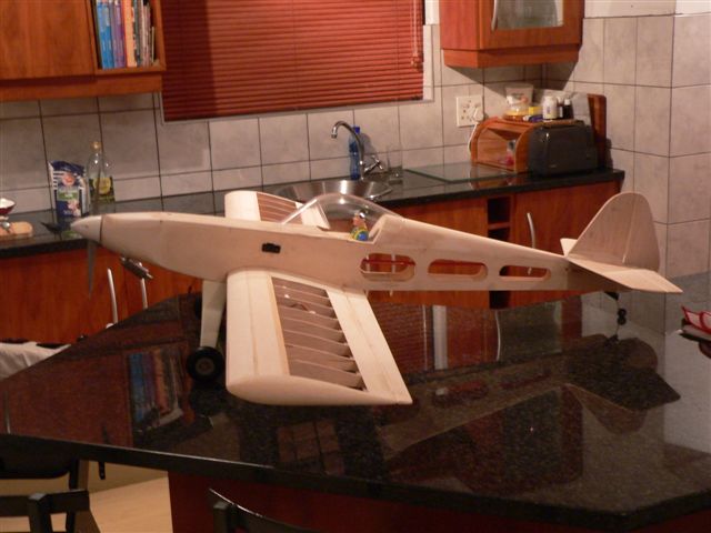

I built mine with extended tabs on the bottom of the rudder for the leading and TE stock to go down into the fuse. Also turned the canopy around and rounded the wing tips. Checkerboard bottom... Sweet flying plane.
