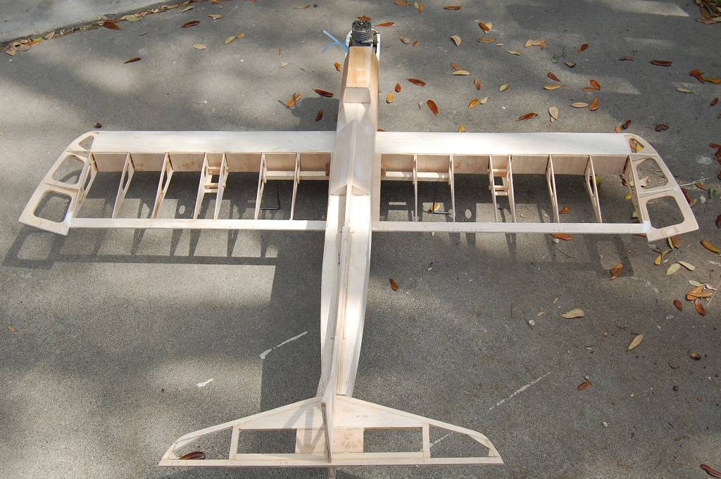

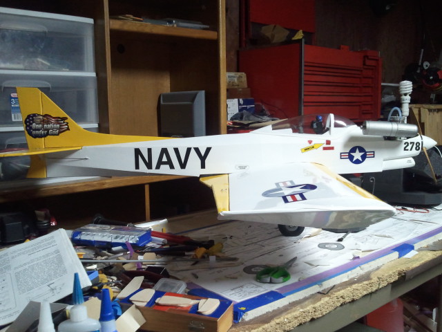

Joined: Jun 2009
Posts: 1,207
From: ft payne, AL
All the kits mentioned are good choices. I started building my second Tiger 60a few days ago. Take into account it is my second Tiger in 1 year so.....it only took me 1 evening to build the fuse. I built the tail feathers this morning. The wing takes a little longer, but not much. Maybe 3 -4 evenings. And then the radio/motor install and covering. All the kits previously mentioned are probably just as easy. But as GreyBeard says....5 yrs flyin may mean those are not what you are interested in flyin now. The Tiger is a very good 2nd or 3rd plane. I am not at all sure if it takes more runway to land than a 40 size. Takeoffs are in less than 50 feet.
My Feedback: (-1)
Jet, Crash and Steve came up with another all time favorite kit and it is an easy build and great flying machine.
The tools crash mentioned are nice to have, I don't have all of them but I get by.
This is a photo of the plane I'm finishing up right now, it's not a kit and it's not an easy build plus it's 1/4 scale so it's not small.
My main building tools are the exacto knife. I only used two blades but I sharpen them on a stone and strop, I strop them as soon as they show any sign of dull. T-pins, I have a couple of packs I have used for years. Clamps of different types I use a lot of but I buy them at harbor freight so they are cheap. A razor knife is great I have one plus a cheap cut off saw. Glues of course, I use a lot of CA and epoxy. That's about it. If you think you need something go buy one.
The number one item is my building board. Mine is old and made of pine but #1, it's flat!! Go through the list crash gave you and I bet you have a lot of it at home right now.
Later on a covering iron and maybe a heat shrink gun? Nice to have even if all you ever fly are ARFs.
Good luck to you and just holler when you need help!!

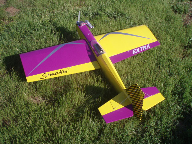

Joined: May 2009
Posts: 157
From: steamboat springs,
CO
Balsa USA makes a kit designed as a kit building trainer. They've specifically designed the kit and instructions to teach all the primary kit building skills. It's a high-wing cabin aircraft with ailerons. Sounds like just the ticket.
Joined: Apr 2011
Posts: 90
From: Monmouth County,
NJ
Sig Somethin Extra looks like a really fun plane, thanks for the suggestion! The Contender looks a tad too fast for my field, and I've decided that I certainly do want a more aerobatic plane than a 4*. I'll look into the Extra a bit more
