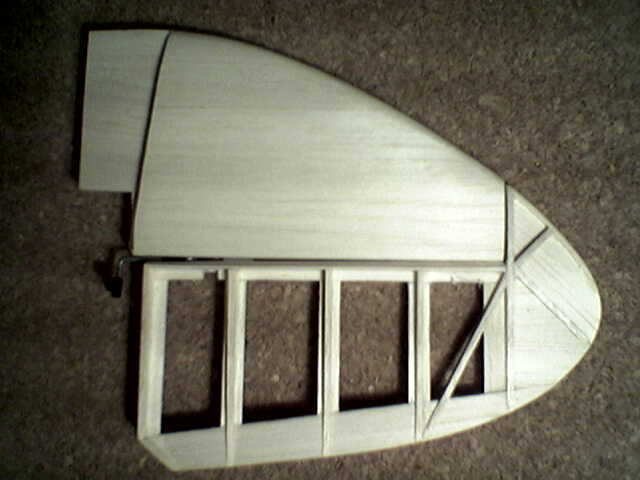

First try at attaching a photo.
Old 01-03-2004 | 07:59 PM
Joined: Apr 2003
Posts: 147
Default RE: Chipmunk by Airsail

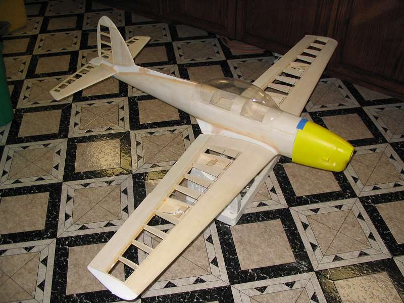

Okay, that worked! Here's another of the Airsail Chipmunk. You can see the plane is built light. Much of the wood is very soft. The fuselage (IMO) needed to be glassed to give it more durability. I've used Silkspun on this fuselage which really makes it tougher.

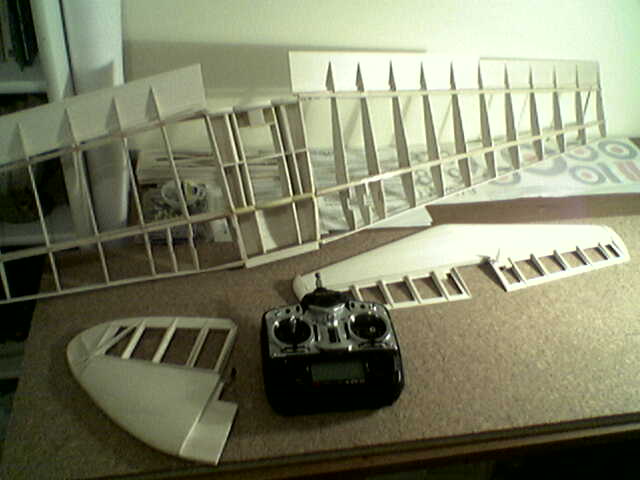

And a couple more.
ID:	87428   Click image for larger version
