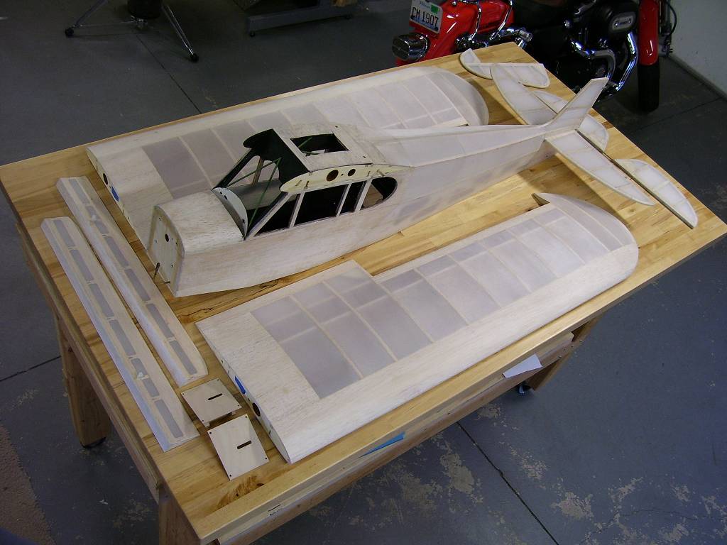

Couple-a weeks ago I got some good advice here on RCU about using Sig Koverall and nitrate dope to cover my 1/5-scale Sig Cub. It turned out great! Thanks to all who helped get me started, see pics below.
But now it's time to prime, and I have purchased and plan on using Nelson Hobby Specialties primer and color paint.
Except, the bottle of primer specifically says NOT to use it on open fabric areas. Now, I have gone over all open areas with 2 coats of nitrate dope... can I not then use the Nelson primer?
Anyone who has used Nelson Hobby Specialties (System 3) paint over fabric, did you use their primer on the open parts, or something else? Any help/advice is greatly appreciated!

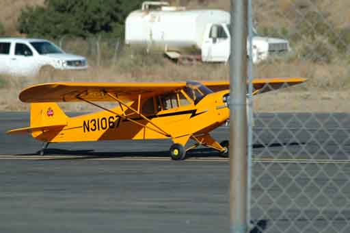

Hey! I make Cub graphics and lettering!

On a fabric covered airplane the only place I would use primer is where I wanted to simulate metal panels anyway. Just paint over everything else and you will still see the fabric weave. At least that's the look I go for.

Smithcreek, thanks for the reply. I will get some white to prime with, and go from there.

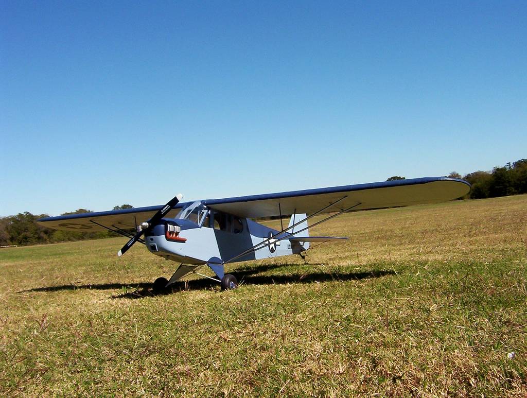

My 1/5th Cub was covered with Koverall, 2 coats of nitrate dope and painted with latex. Iagree with smithcreek about the limited use of primer only to simulate metal panels, etc.

Ok, I got the "straight dope" from John Desilets at Nelson Hobby, and he says I can simply scuff the nitrate-coated fabric and apply the paint directly, no primer necessary.

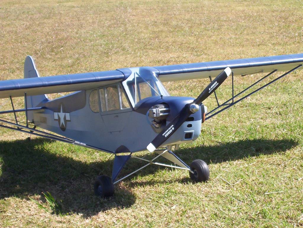

I painted my Sig 1/5 Scale Cub with Nelson Hobby Paint directly over the SolarTex covering. No Nelson primer was used except on the landing gear and on the aluminum struts. Paint has held up great over the couple of years I have been flying it.
I found the Nelson paint a little difficult to use so I doubt I would choose that paint again. Like I said, it is holding up good, but it seems to resist everything including itself when painting. I had to mask everything, spray the color, then cut around the entire mask to prevent the paint from lifting as the mask was removed. Then I had to clear the entire plane to prevent each colored from lifting at the edges. My Cub is all Nelson paint with no stickers. I gave up on the paint and omitted the numbers from the sides of the plane.
Let me revise an earlier statement. The Cowl paint is not Nelson, it is AutoAir colors with PPG clear. I had the clear on hand and I hand mixed the AutoAir colored to get the correct blue for the cowl.
The 1/5th Sig Cub was one of my favorite builds, a great kit. And it flies excellent.

ORIGINAL: SunDevilPilot
SunDevilPilot

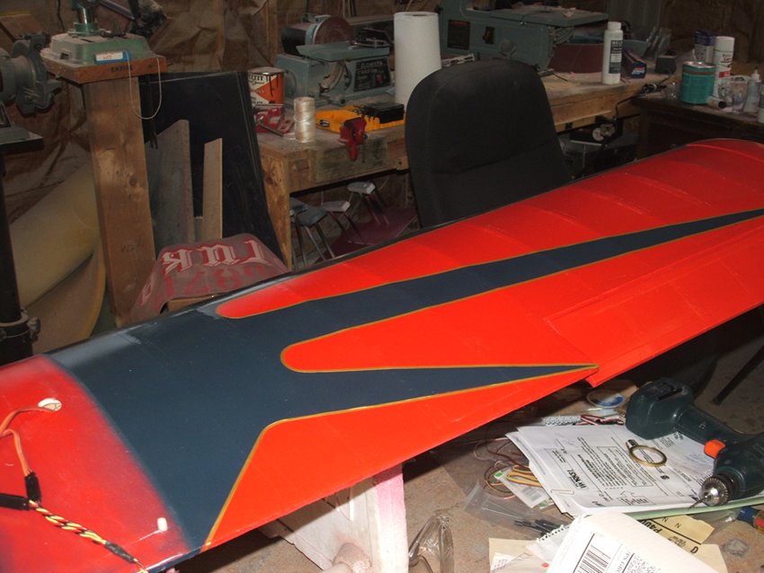

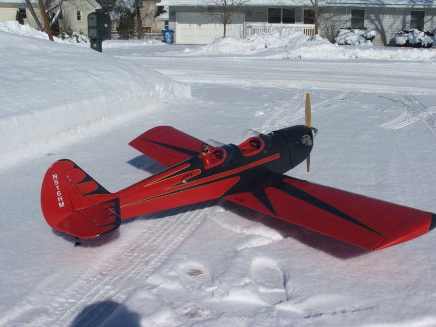

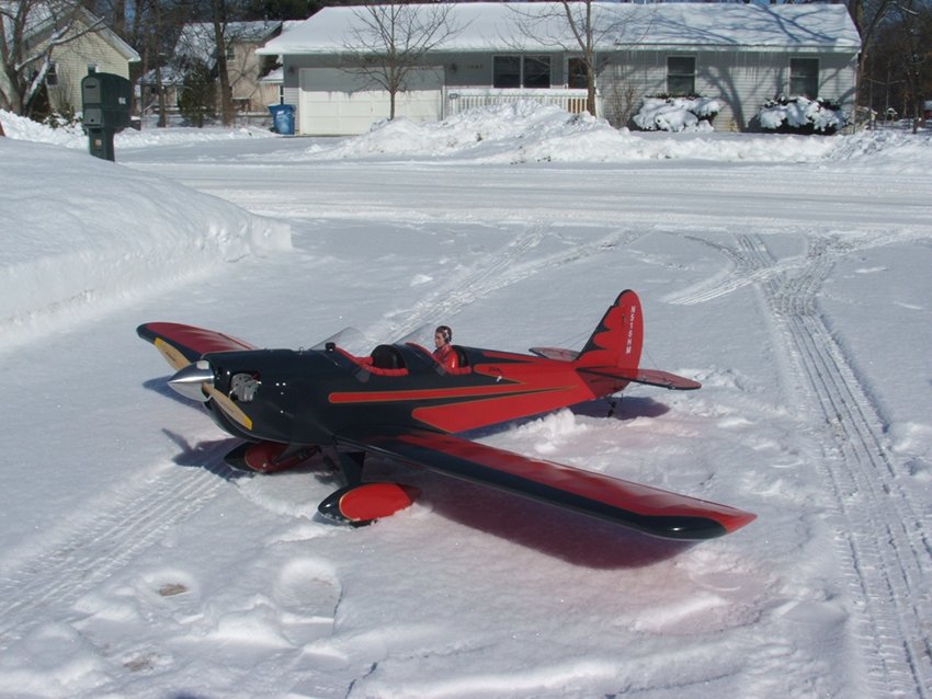

Interesting statements, but I found none of these problems. On the model pictured below, I sprayed the red, and let it sit until the next weekend. At that time, the dark blue was applied. The masking was pulled, approximately 1/2 hour after the final coat. I am very pleased with the results.
The primer was used only over hard surfaces. The model is covered in Solartex. All open areas were left unprimed.
