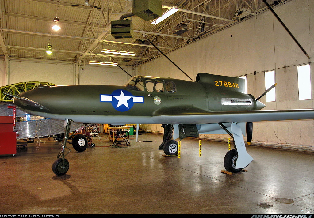

I have a friend send me cad plans for a ascender ,63inch wing span . I think i will blow it up to around 80 inches and put a big brushless motor in .

joebahl, is that ascender warbird plan from a friend by the name of Les in Wy? don

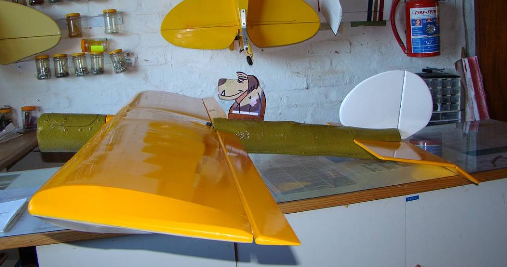

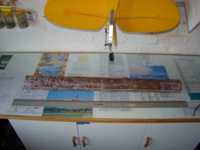

Over here it is not winter, it is Springtime... and the tree in the backyard produced seed pods that makes you itch like hell, so it had to be chopped off.
Now I hear a chorus "so, what's a tree in your back yard got to do with rc flying?
Well, when we chopped downthe tree, I noticed that this tree trunk have some aeronautical possibilities.

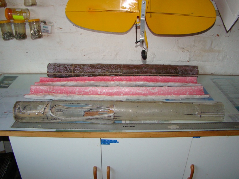

So I selected the best part - just over 1 m in length and slightly curved downward towards the front.... I've built a numberof Das Ugly Sticks in the past and "Stick" can also include "Tree trunk", so why not build a "Das Ugly Tree trunk"?....

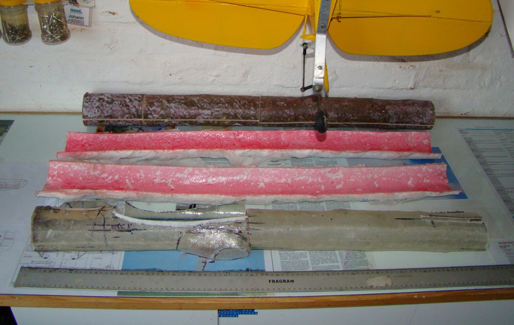

I cut the tree trunk (see pic 1) to the right length, seal it with sanding sealer to preserve the bark, applied a couple of layers moulding wax and spray it with water base mould release - as the bark have a rough texture and I want to preserve it for the looks.
Then I coated the trunk in moulding resin and glass. When cured, I splitted the mould lengthwise with a circular saw and pulled the 2 halve moulds off the trunk. (Pic 2). Then I layed out a fuse and once cured, pulled it out and added some details i.e. "a knot in the wood aka cut off branch"., then made the cut out for the wing and tail feathers. The trunk had a slight bend in it at the base (now the front of the plane and I used that to offset the thrust that way. Careful measuring out of the wings (1.4 m) and tail feathersfollowed - scratch build of course, see pics.

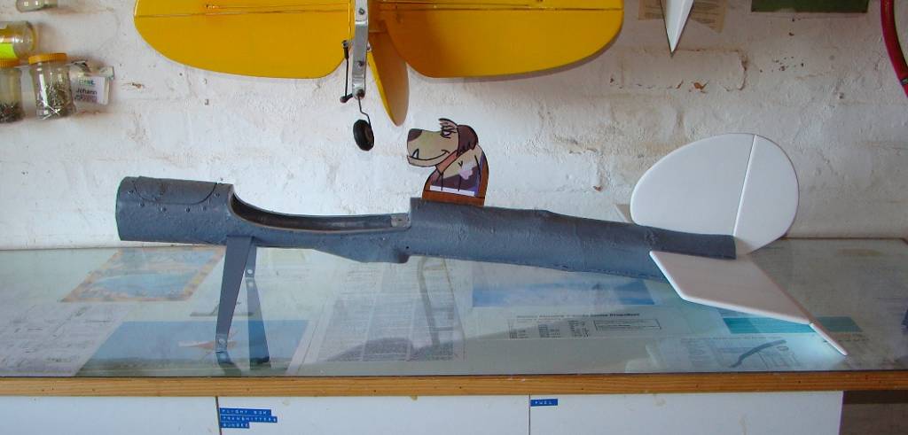

Then a primer coat on the fuse.I took the tree trunktoan automotivepaint mixing shop - they probably thought this guy is a littlenuts walking into an automotivepaint shop with a tree trunk... but they understood the application and after a couple of jokes and I got the paint.....

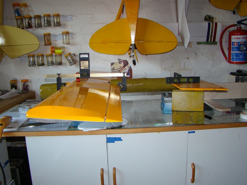

Then followed thefirewall and formers(I cut the tree trunk just before the LE and behind the TE to get the profile for the formers).
Tank and radio gear followed - oh and a plywood Muttley, I could not made up my mind whether it should be a "Flintstone Flyer" or a Muttley Machine, I think the latter won. I will complete the plane late in October and plan to maiden it then - this isone Das Ugly Stick with one way out theme.... <o></o></span></p><p class="MsoNormal" style="margin: 0in 0in 0pt"><span style="font-family: "><o></o></span></p><p class="MsoNormal" style="margin: 0in 0in 0pt"><span style="font-family: ">Maybe load up some of those itchy seed pods from the tree and go to some fly inns with the Muttley Seed Pod Bomber&hellip;&hellip;&hellip;
Will keep posted.
Cheers
Bundu</span><o></o></p>

Too funny. I love your stick!

I love it!

Bundu, you are indeed the best "bundubasher" i know. you win the award for sure. all from a tree. WOW now when you fly it into a tree, it will feel right at home. LOL don

WOW! Now there's an Ultra Stick!

No by jamie in tenn .
