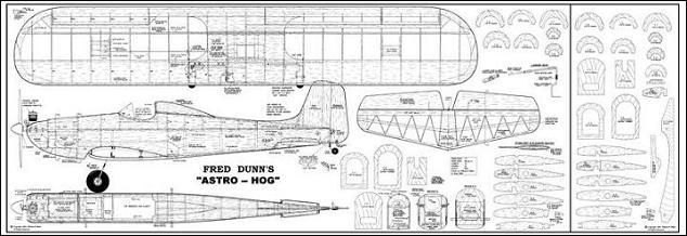

Default Scratch building Astro Hog ( help with tail)
Scratch building an astro hog from plans from 1983. I think I am missing some prints, I know I am missing the picture book that came with it. Having trouble figuring out the vert stab FN-1 FN-2 and FN-3 and how they go together in relation to the horizontal stab and elevator. Also how to connect it to the fuse. Some close up pictures of the rear of the plane in the bones would be great, or some pics of the parts from a kit. Remember I am building all these parts from scratch , no kit.

Hope this helps. The instructions aren't clear enough to scan. The bottom of fn-3 glues to the back of the fuselage. The front bottom of fn-3 and bottom of fn-2 glue to the top of the stabilizer. The bottom of fn-1 glues to the stab, back of the last former, and top of the fuselage.

I just started scratch building a Hog fuselage today. I had one years ago (still have the back half of the fuse and the wing).  If you have the side view on the plans, that is the only picture there is of the verticle stabilizer except for some pictures in the instruction book.  F1, 2, and 3 are 1/4 balsa glued together - the bottom of them fits the contour of the fuse without "'keying" into it, it just gets glued on top. It needs a little half hole for the elevator joiner dowel. The rudder is 1/4 balsa tapered thinner to the back. There are also some triangle shaped fairing blocks that go on the front of the horizontal stabilizer towards the front of the fin. They are necessary because the horizontal stab is tapered, it gets thicker in the middle.  Do you have the horizontal stab figured out yet? Maybe you haven't gotten that far yet.

Hey, Thanks alot guys. It seems hard to believe that the vert just butt glues to the top like that, but I guess it doesnt really have a load on it. The guys in the other forum said the tail section was held on with rubber bands, is that true?
As far as the horizontal stab... I think I have it. Those 2 main spars that sit on top and bottom of the ribs create the airfoil once the covering is stretched over it, am I correct?

That is correct and it creates a nicely stiff, strong, and lightweight stabilizer. The filler blocks that glue to the sides of the fin provide good bracing for it. The stabilizer center section has some 3/32" sheeting.

There are no rubber bands anywhere, maybe the very first Astro Hogs built in 1957 used that -but not our planes. It sounds like you have the horizontal stab figured out. There doesn't seem to be any drawings of the top formers F3 and F4, we'll just have to measure the height off the plan and fake it. These aren't really plans that were intended to build a plane from, just instructions for a kit - but there's enough info there to work with.

Jim, I made the F3 the same as F2 Just the top half. and F 4 just about 1/4" taller than F5, it gives you a straight line to mount the headrest on.

I found this on the web.. side view..
