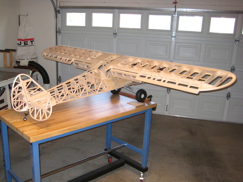

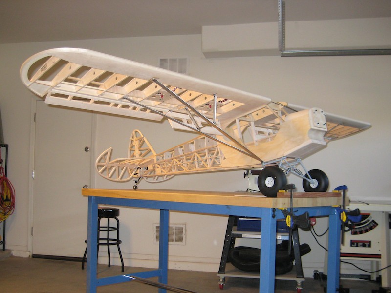

Just a couple examples of woodworking tools at use in model building.
I would like a spindle sander but for now I use a drum sander in my drill press, which is another "must have" tool.
(A few photos of my current project, a 1/4 scale Sig Cub..... Build thread in the kit building forum)
