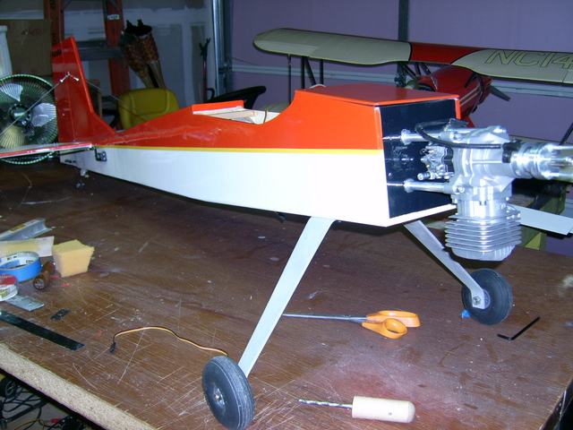

redbiscuits's Avatar
Joined: Mar 2009
Posts: 1,470
From: CEDAR CREEK, TX
Default RE: Fuel-proofing engine compartment?
I first cover my models and then mask off the area to be painted. I then paint, and then seal the paint and edges of the covering with Z-Poxy. Darker colors work the best because the Z-Poxy doesn't cure completely clear. I just used regular cheapo paint from Wally-World.
Hope this helps.
