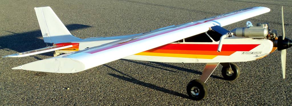

Clip it! Why not?
While its still uncovered flatten it too
note:not a LT40 but is my "trainer"

<span style="font-family: Comic Sans MS">what do you mean flatten it? the airfoil? sanding down the ribs? </span>

ORIGINAL: crash bandicoute
<span style=''font-family: Comic Sans MS''>what do you mean flatten it? the airfoil? sanding down the ribs? </span>
I'm assuming remove the dihedral.....
did it to mine.. lots of fun
