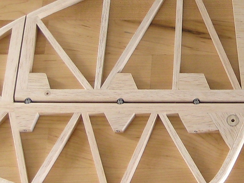

What do you use to acheive the taper from the barbed shank to the nuckle when installing hinge pins? I'm using the 1/8 inch hinge shank and have never found anything that matches the taper (from !/8" to 3/16' over 3/8" long) to neatly drill the hole that recieves the hinge? This is a popular hinge method & I assume that I'm just unlucky, I've tried stone grinding cones, carbide burr's, reammers, ect, and cannot find the right tool to give me a nice neat tapered hole that matches the pin! Thank You for you help.

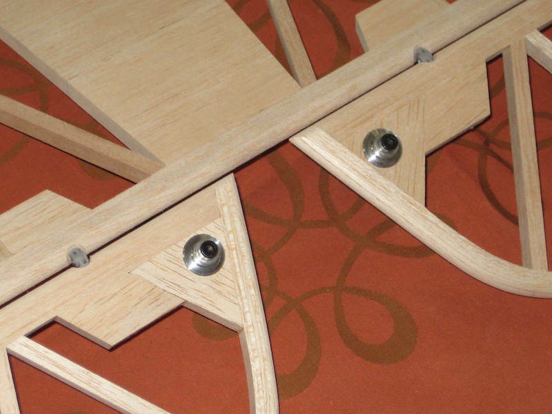

I have encountered the same problem but came up with a different solution. Instead of tapering the hole I sand a half circle into each side of the surface totally exposing the knuckle of the hinge. This makes gluing quite simple, because at no point will the knuckle encounter glue, and the hinge will seat all the way into the surface.
Here is a photo of the hinges in a flat surface. It works with a beveled surface too.
My tool of choice is a hand held dremel sanding drum... It is just a tiny bit wider than the hinge. Only takes a few minutes to compete a surface just rubbing the bit acros the hinge pocket.

I do the same thing except I use a 1/4" dia round file. I then saturate the hole and the crest with thin CA. Beautiful work on that tail section Sun Devil!

Thank's for the tip's guy's, I'm doing a re-fit where one surface is square and the other beveled, hence the quest for a tool to fit the hinge pin into the square surface, using a small sanding drum to cut a semi-circle looks like it works nice on rounded or beveled surfaces, but on the square, I'd rather have a nice tapered hole.

I know it dosen't need to be perfect, But I want it to be! Just a personal preference, One of the things I look for when checking out a fellow modeler
s plane is a neat hinge line. We all got our quarks! Look at the pic's SundevelPilot posted of his hinging, based on his work, I have allready formed a high level of respect for the man.......Crazy...Eh?
