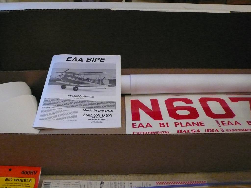

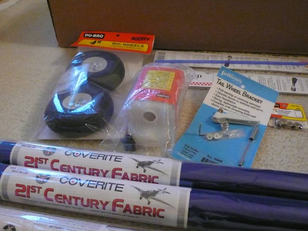

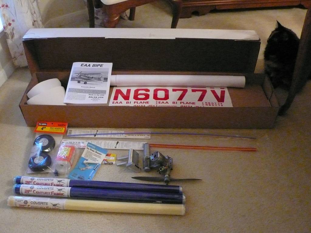

I just got a 1/4 scale, EAA Biplane from Balsa USA (BUSA) which I orered on-line from Stewart Aircraft of Michigan, great place to get BUSA kits and products. While I collect the accessories and hardware necessary to complete the kit, I thought I would check the kit building forum to see what other builders of this kit had said about it before laying out the building surface. I could findno current posts and mostcomments on this kit are from 2008 or 2009 and before, it seems. I am planning on using a Super Tigre S-75 for power; one of the olderengines made in Italy that I got when new and it has never been ina plane. I am also trying to find more pictures of models and full sizeEEA Bipes to select a color scheme and order coverings and paint.
I am currently finishing a Phaeton 90 and I am familiar with comments made about Balsa USA basic instructions for their kits but it looks like te EAA Bipe has a fairly good number of illustrations compared to the Phaeton instructions. I have seen quite a number of comments about the incidence set ups for the Phaeton 90 and their effect on flyability and would like comments from anyone having built and flown a BUSA EAA Bipe. I have flown a Phaeton 90 and agree with the many comments on the negative elevator trim necessary when the Phaeton is set up per the plans. Unfortunately for me I read those comments after my Phaeton was substantially complete andhope to hear aboutany such experiences with the EAA Bipe before I start.
I'll be posting pictures as I go and hope to spur interest in what appears to be a great little plane at a great price. My first look at the materials and plans are very positive and I am anxious to get started but, the covering of the Phaeton 90 and a GP 60 size J-3 Cub are still on my plate, so I still have a couple of weeks to gather any comments about this kit from others with experience. So, let's hear from those closet EAA Bipe builders out there; come forward and be heard.

I've got most of the things on hand to begin the construction but still finishing up two other projects, currently. I've decided to cover the model in iron-on fabric in cream and medium blue. I'll probably add some red accents but still working on the finishing details as I gather comments about this kit and experiences others have had in building and flying it. I got the Pitts muffler for the old Italian Super Tigre 75 and will probably use the ABS cowl that came with the kit for now. I haven't decided on whether to use the "N" struts materials that came with the kit or to "upgrade" to some of the air foil shaped extruded aluminum to make those. I will make sure to use heavier strut and cabane attachments with blind nuts as I used in the Phaeton 90 I am completing. Anyway,following are some pictures of the basic stuff, less radio and camera mount, etc. to get the Balsa USA 1/4 Scale EAA Bipe substantially completed.

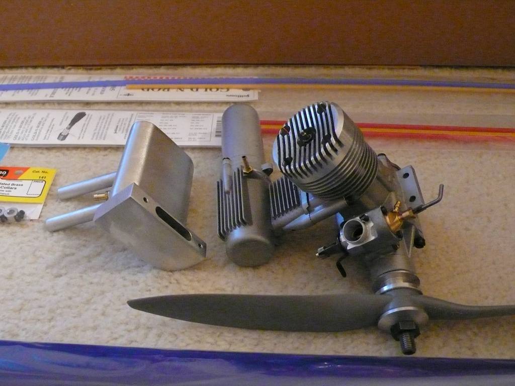

This is WAAAY past the original postings but I am also building the EAA Bipe. It's an old kit, die stamped but still good. My problem is that the cowling is just too small to work. I'm using an electric motor mounted directly to the stock firewall. Any suggestions would be appreciated.
Too small in all directions. It would fit if the motor was extended out about 2 3/8 inches. The ones that are available to buy do not list their dimension. No other choice but to fabricate one.
