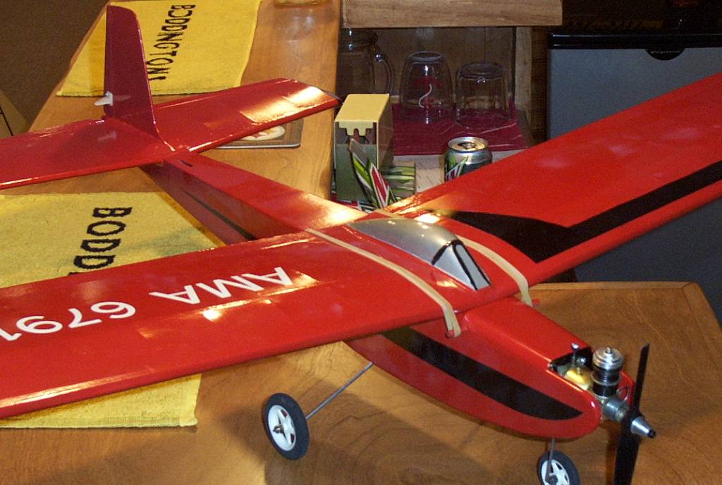

quote:
ORIGINAL: jessiej
Has anyone posting in this thread tried the ''meniscus method'' of dope application to silk? It works quite well with a bit of practice.
jess
Yes. The Jr Falcon is Polyspan which someone mentioned and the Buster is silk and dope. Both have KlassKote Paint.
John
ID:	1739188   Click image for larger version

Is KlassKote Paint fuelproof or do you have to apply dope over it?
Went to the site and answered my own question. Now, after mixing 50/50, how much reducer/thinner should be added??

ORIGINAL: Rubbernecker
quote:
ORIGINAL: jessiej
jess
John
Both the models look great! I didn't know that method would work with KlassKote. I will give it a try.
jess
